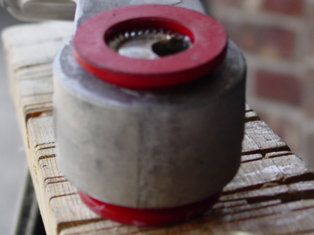

Vance,
The bushings go in both arms so there is two bushings per side. Here is a pick of the bushings.
Jeff

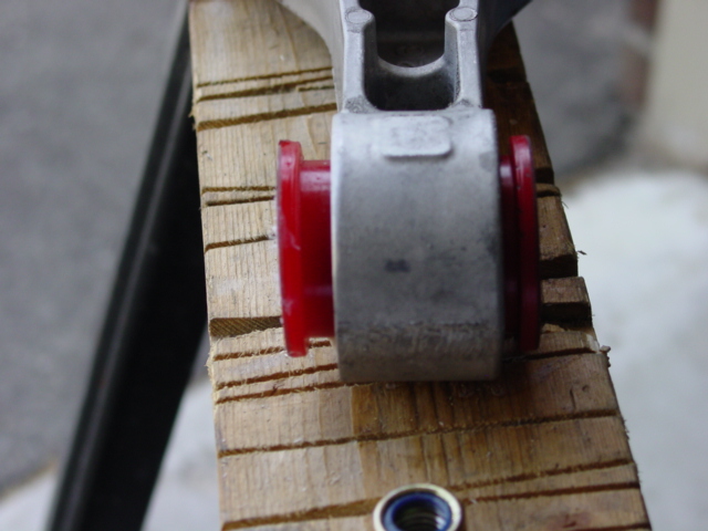

Another in the lower arm:

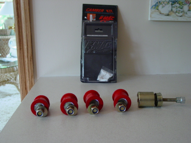

Another:
