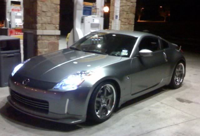

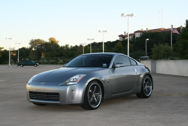

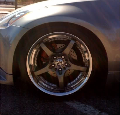

Don't believe everything you hear. I am running S-Techs with 19" Volk SF-Challenge wheels and the drop made the car look 10x better. The wheel gap is only about one finger and I didn't have to roll the fenders. Here is a pic. If you want more I can post a few others.

Very clean ride!

damn thats perfect! i didn't want mine to bee tooo low and freakin scrape everywhere i go! do you scrap like crazy? and i heard they ride smoother then the stock ones. but ill need a camber kit for sure huh?

Ride is a bit more stiff but the car handles much better. I don't have a camber kit installed on my Z. To me it doesn't seem necessary because the negative came isn't too bad. I am going to take it to a shop sometime soon and have them check if my tires are wearing evenly but from what I can tell they look ok.
As far as scraping goes, its not too bad at all, just be careful. I have a Nismo front lip and even with that, the scraping is very minimal if you are careful. Speed bumps and semi-steep driveways don't seem to be a problem.

Burner are you running stock shocks? Your drop seems to be more than others from Ive seen on here.

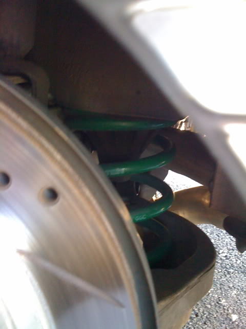

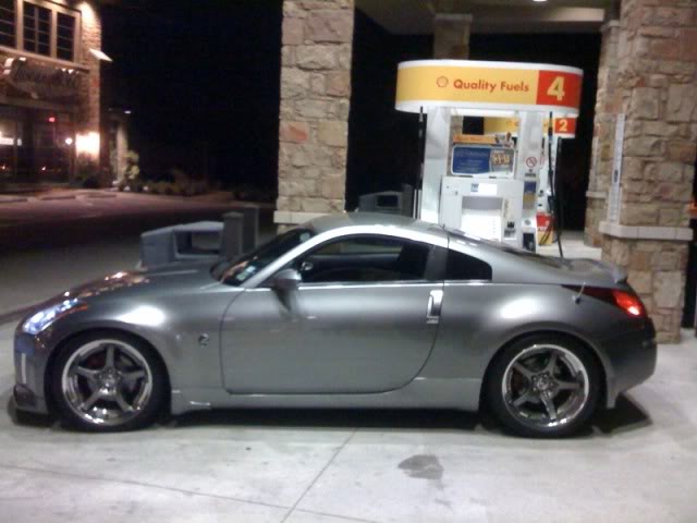

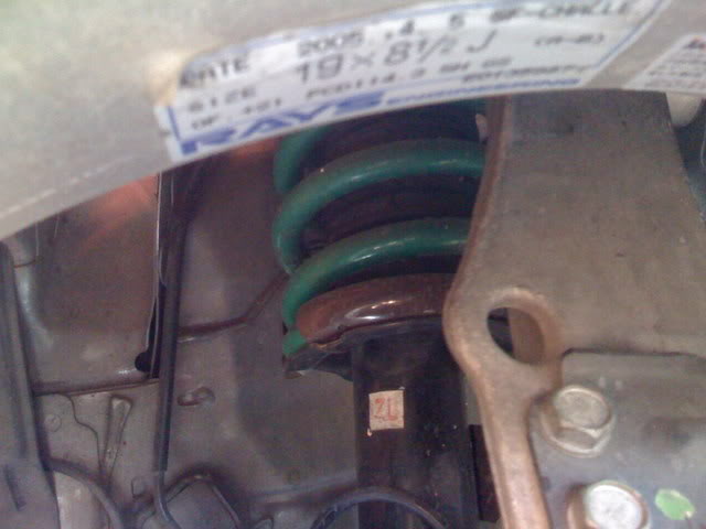

Yeah, I am running the stock shocks. No other upgrades besides the springs on the suspension. The springs I bought used and I have had them on the car for awhile (had some 20's on for a bit as well) so they are pretty well broken in. I'll post another pic so you get a better idea.

i believe your stock shocks are blown or something. i've seen tein stech springs in person on 19s and they def don't look as low as your pic.

I don't think they are blown. I installed the springs myself and double checked everything when I had the suspension apart but I could be wrong. How would I tell if the shocks are blown? Usually if they are blown you get a floaty, bouncy ride which I don't have. I think maybe the crappy phone pictures make it look a bit lower that it really is. I will go out and take a few more pictures and post them up in a bit.
EDIT: Come to think of it, I did do another mod awhile back before the springs...The springmount cutting mod. Only did this on the rear though, and only cut about 1/4 inch off of the rubber. This may contribute to the lower ride height in the rear, but the fronts are only the springs.

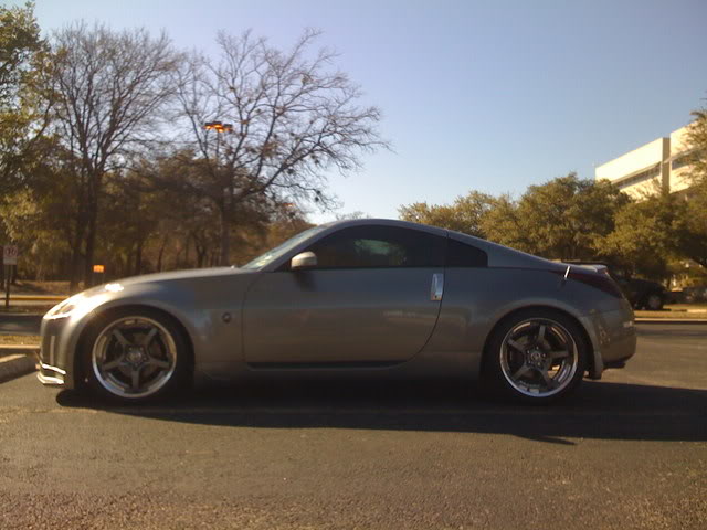

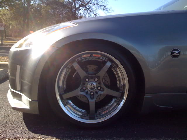

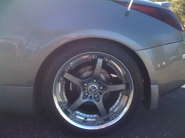

Alright....just went out and took a few more pictures. Sorry this is the best I can do I just sold my DSLR camera and don't have a point and shoot, so I had to use the phone. I am running BF-Goodrich KDW's 245/35 and 275/35 incase anyone was wondering...

Well that explains it. The spring mount mod is what is making the difference. Without that, your rear would sit up about another half inch or so.

yeah looks like a hotchkis drop now

Burner, I was gonna say that no way does your car have S-Techs as your car looks lower than others, but now it makes sense because of you cutting the spring mounts.
IMHO it's a waste of time to buy the S tech to then later go through the hassle of cutting your spring mounts. You should've bought Hotchkis springs to begin with which would've given you the same after effect and still stay close to factory alignment spec.

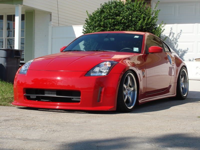

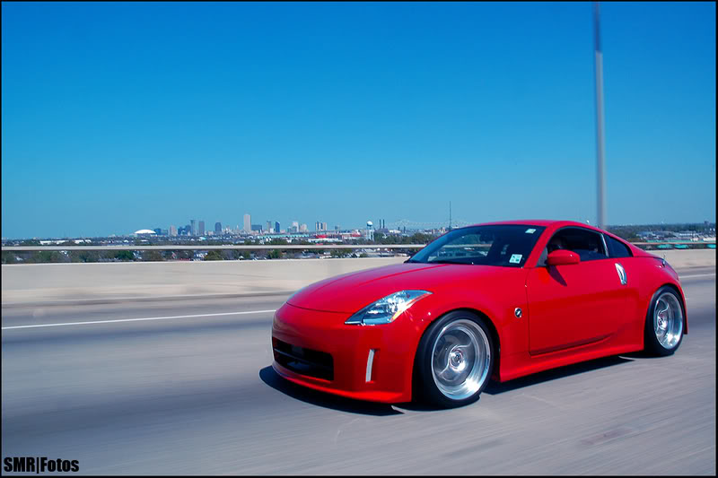

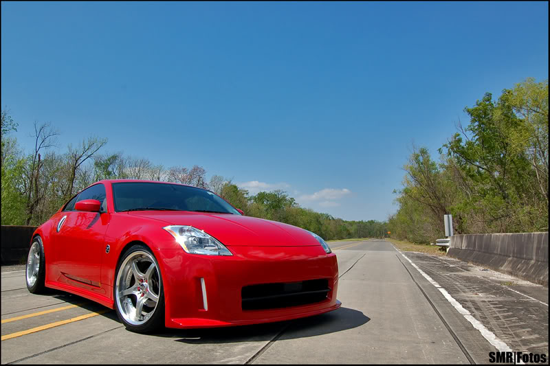

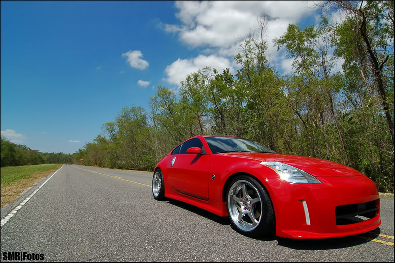

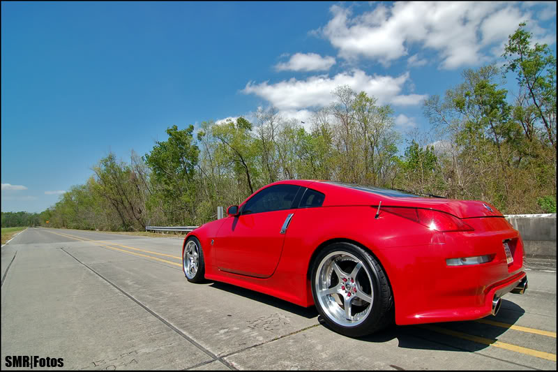

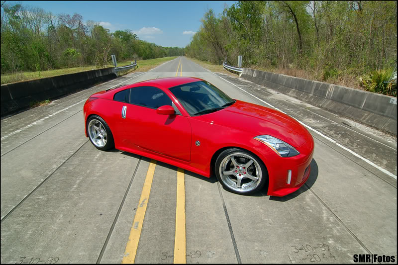

Here is my Z sitting on S techs w/o springmount mod.
Spacers in the front with 255's and 285's in the rear make a big difference
Comparison with the BC Racing below..

omg that's pure sex.

That red Z a few posts up (sweet by the way) looks as low if not lower than mine and he is running the S-techs as well. I do think that how the drop looks has alot to do with your offset and tire/rim width and sidewall size as well.
