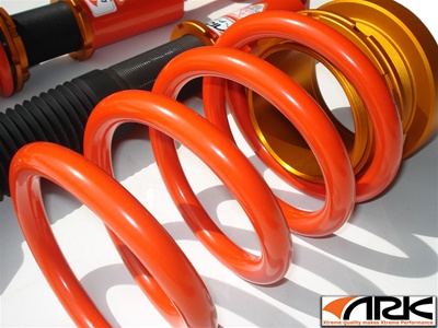

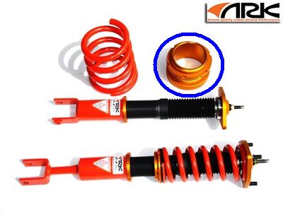

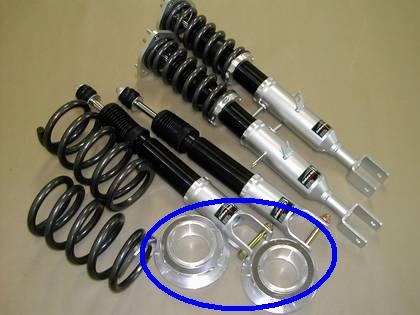

SPL makes a replacement for the entire rear mid link, and are made for 2.5" diameter springs...
But I think the OP is looking for just a rear spring mount adjuster, like what comes in one of these coilover kits. They fit the OEM rear mid link and OEM 5" diameter springs.
Attached Thumbnails who makes an adjustable rear spring mount??-ark1.jpg   who makes an adjustable rear spring mount??-ark2_circle.jpg   who makes an adjustable rear spring mount??-endura-tech_circle.jpg
