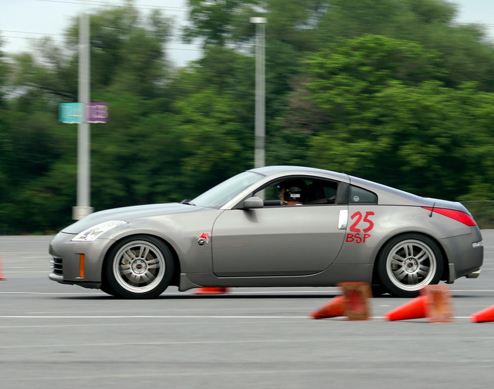

Default Hotchkis...
Just ran my first autocross with my new Hotchkis sways installed and all I can say is "wow".
Very stable platform. Push is pretty much gone. I'm set on the second hole from front in front and softest in rear. I'm running on 8.5x18 Enkeis and 245 Star spec Dunlops at the moment. I ran 39 psi up front and 42 psi rear.
I'm gonna try a stlighty stiffer front, just to experiment, but this seems to be dead on right now.
Yellow Konis are next.
I'm a 67 year old geezer and ran well yesterday.
