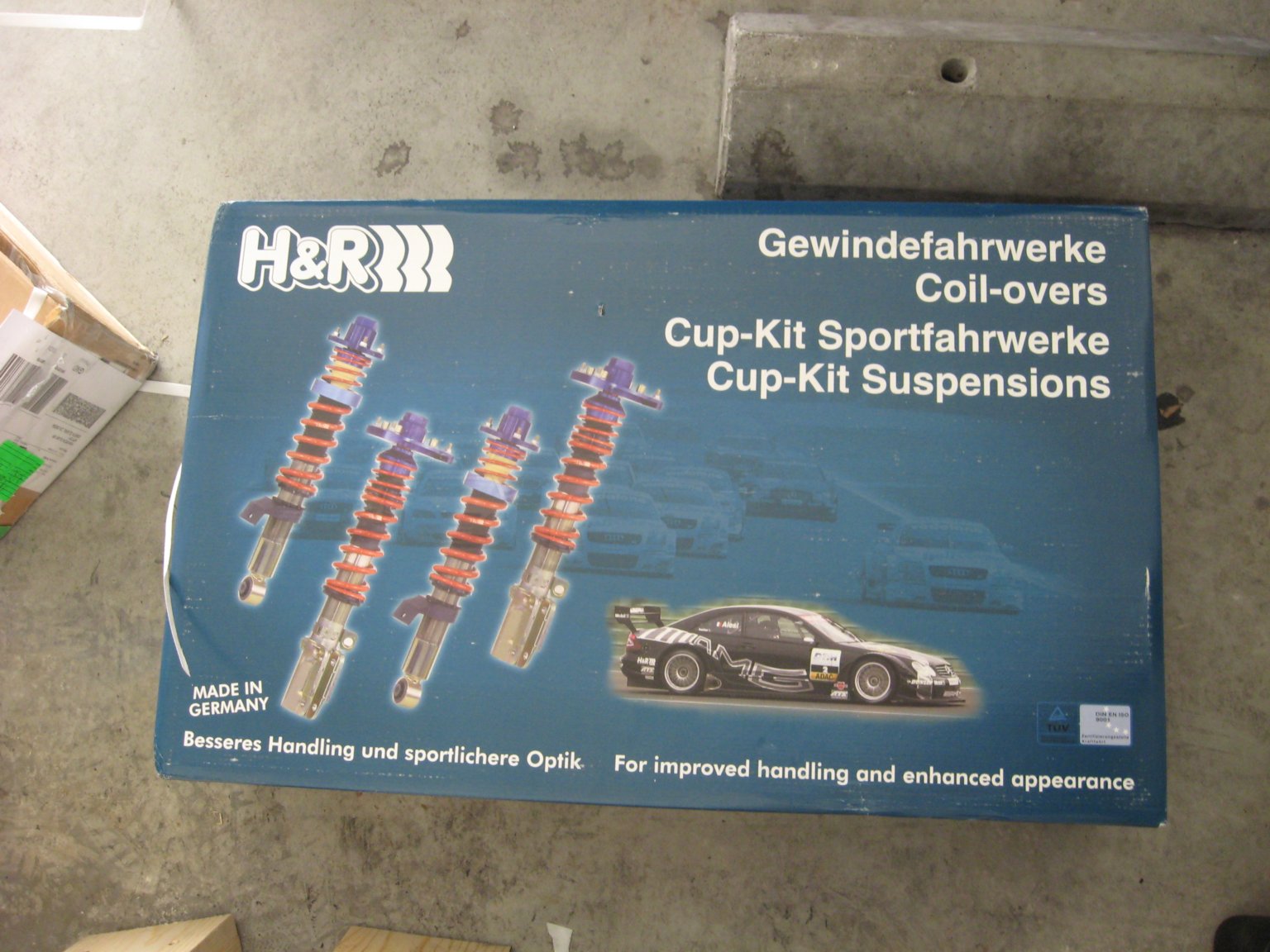

edit: I am updating my review of these coilovers as my initial review was inaccurate. I had the coilovers installed incorrectly which affected the ride quality. Here is a more accurate review of the H&R coilovers:
The only other coilover setup I've driven is BC racing.
The H&R coilovers are progressive springs and there is no dampener control on the shocks (comes preset from H&R). H&R does not disclose their spring rates, which sucks, but I think they are comparable to BC, if not a bit stiffer. There is a big range of height adjustment. H&R states a 1.0" to 2.25" drop range. The coilovers are 1 way height adjustable.
Ride quality is comparable to BC, perhaps slightly stiffer. My initial review said the ride was very stiff, but this was due to me dropping the car only .75". I have other threads in the suspension section asking about preloading springs. There is too much load on these springs if you drop less than 1.0". This is why H&R recommends at least 1.0" drop. After adjusting the drop to about 1.2", the ride quality significantly increased and this setup was very easy for daily driving.
On the daily roads the suspension held comfortably through the bumps and dips. There is noticable difference than stock of course. I wasn't able to autox in these yet but steep on ramp turns felt more in control and the car was well balanced. There was almost zero body roll.
The thing to note is that these coilovers require at least a 1.0" drop. Thats kind of the drawback of using 1-way adjustable coilovers (you put load on the springs to raise the car). But then again, I suppose if you want less than a 1" drop, you shouldn't be looking at coilovers anyways.
Some installation tips: The rear spring perch sits on the bottom, not top, like BC racing. This makes it difficult to adjust while the spring is loaded. Luckily, its very easy to access our rear springs on the 350z. Also, during install the rear rubber mount (lower) should be removed to give a metal-to-metal contact between the spring perch and spring bucket. I didn't like this so I kept the rubber mount in. This didn't cause a problem and avoided any noises.
Generally, the cost of H&R coilovers seems comparable to BC racing. But for some reason, these coilovers can occassionally go on sale for a very low price. I think the MSRP is like $1300 or so but I was able to find sets for under $900.
