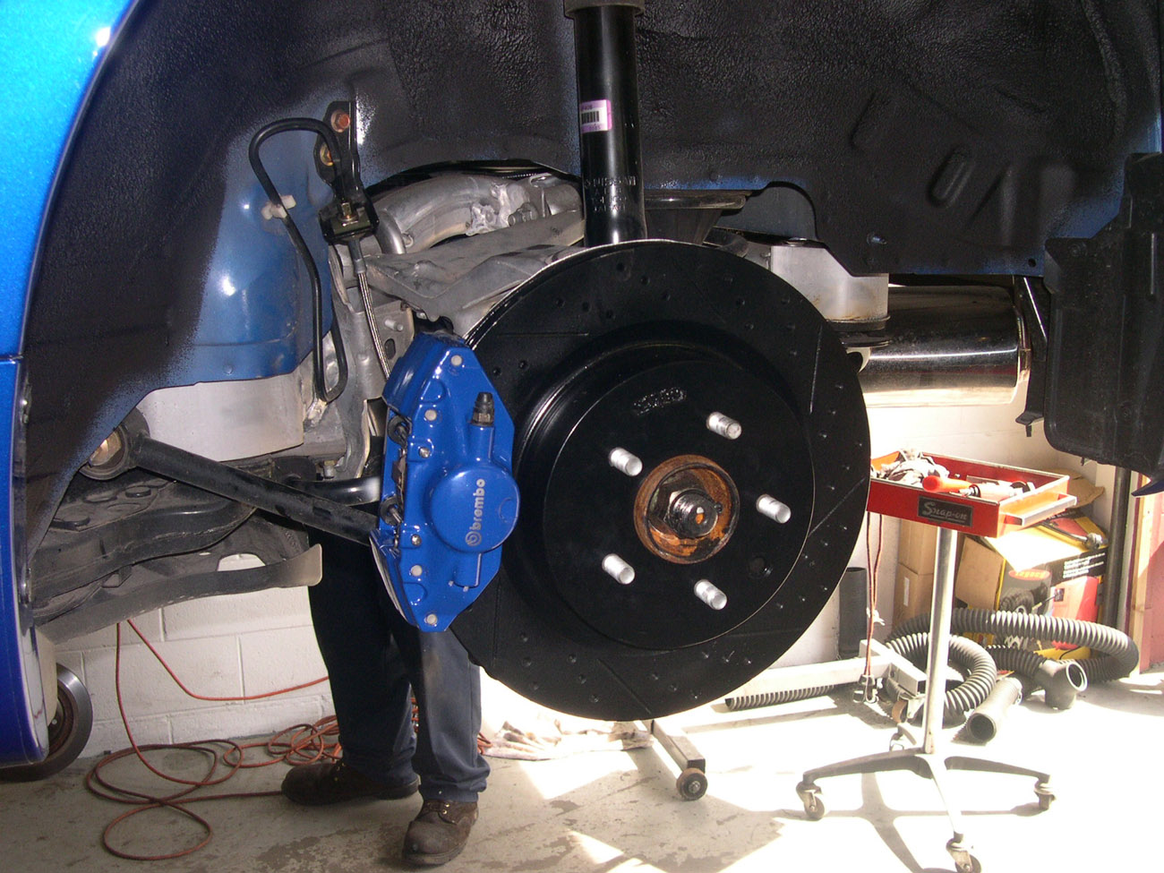

When I switched from non brembo to brembo I found that the bolts were the same size but had a different thread. Also you will need to trim the rear dust shields because the rotors are bigger than non brembo package.
