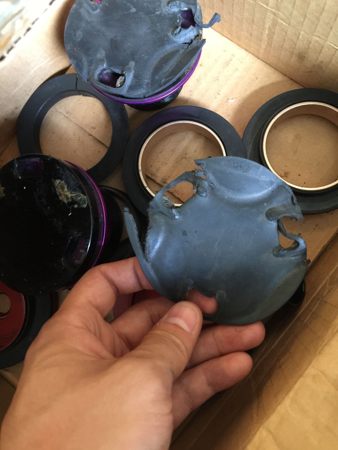

Hi guys, I was also having an issue with my KW v3's I purchased second hand. The installation guide (referenced below) I downloaded does not show any visual information about all the parts that should of came originally with the kit or any other information about how the spring goes into the spring bucket. I was hoping someone could assist me as well, thank you in advance!
I know the adjuster goes on top but do I need anything else below the adjuster?
I have these two gold inserts with a plastic ring and these two red "cap" looking items with plastic rings. Can anyone guide me? Thank you!
Regards,
Simon
http://www.kwsuspensions.com/product...-v3-14797.html
Do I need new rubber things? What adhesive should I use to hold them in place?
Adjusters go on top correct?
Where do the gold and red go?
