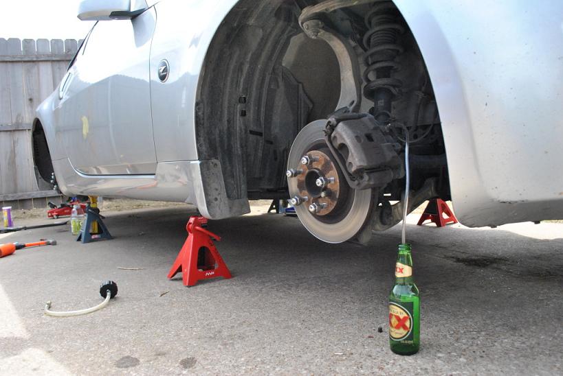

Originally Posted by Zazz93
I use normally one full liter for all four but its nice to have a second. I opted for the Motive catch bottles (2 for $25) and each one can hold about 2 wheels worth of fluid. I can bleed with the wheels on and it take 10-15 mins. for all four (just be careful with the wheel finish). Haven't tried it for the clutch but I may try it shortly.
I use these:
-J
Attached Thumbnails Motive Power Bleeder opinions?-136.jpg   Motive Power Bleeder opinions?-163ps-1.jpg
