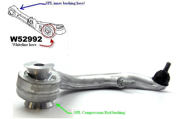

OP...
To answer your question...
- Front inner translink bushing should be SPL,
- compression rod should be SPL,
-but to save you some money you can do the translink shock mount bushing as whiteline as thats not critical.
*Reason being - is a whiteline paired with a spl compression would be a friction point on the Lower arms versus the compression rod....
HOWEVER,
for daily driving though, whiteline at both spots on the translink is more than fine...
trust me, get the compression rod spl bushing for sure...
-J

just spoke with spl and he said that if im gonna use the spl compresion rod bushing.. i should go with the spl bushings for the lower control arm as well.
he said they make an "A" arm shape.. and that if one is solid and one is softer then the tires might wear a little uneven???
so i guess the right thing to do from all your guys advice is..
SPL Lower control arm bushings and SPL compresion rod bushing!

also one more question..
you guys think it would be okay to use the SPL lower control arm bushings with the oem compression rod bushing for awhile?
or you think that might eat up my new tires?
thanks
thanks
ya thats fine.....it will be fine........if your car is lowered, your compression arm is torn.......with out a doubt! just replace it with the spl comp bushing when you can.

Originally Posted by JasonZ-YA
OP...
HOWEVER,
-J
This is what im saying!
Review Translink Item 13 and Compression rod Item 11:
-but to save you some money you can do the translink shock mount bushing as whiteline as thats not critical. Whiteline P/N W52992
that saves you a lil bit of cash....
-J
