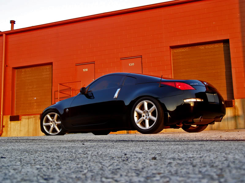

I Ran Tokico adjustables on mine; even on the softest setting, the Sportlines were pretty harsh. The Sportlines are pretty brutal, but they do look kick ***. I am slammed on Powertrix coilovers now with my TT 300Z, and the ride is better than it was in my 350Z with the Sportlines.
To beat a dead horse, don't cut the mounts with the Sportlines. It will drop you far lower than what they are rated at. A few pics of mine on Sportlines & Tokicos; I am also running -2 degrees of camber with 25mm spacers in the rear and 15mm in the front. You WILL need supporting mods to get it in camber spec (I ran SPC front camber arms, SPC rear camber arms, SPC toe bolts), which you might as well do at the same time as you install everything else.
