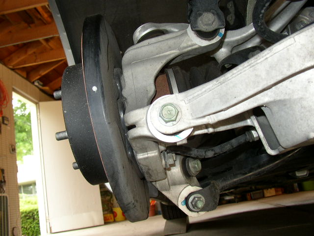

in previous posts some have mentioned removing the dust shield to allow better brake cooling??
is this recommended?
Old Nov 26, 2003 | 01:18 PM
EnthuZ's Avatar
EnthuZ
Posts: 1,965
From: Chicago Burbs
I wrote a "how to" on removing the rear shields a while ago....try a search, I'm lazy. I would say it did help for my track use, but they really need even more cool air. I'm trying to figure out a positive air pressure point under the car to achieve this.....I'll be experimenting next year. If mine was a pure race car, I'd run ducts from around the "B" pillar, as BJ has done, but I'm not willing to chop up my interior .....yet!
Sooooooooo, if you're doing lapping events, get rid of it. For the street or autocross, I wouldn't bother.
