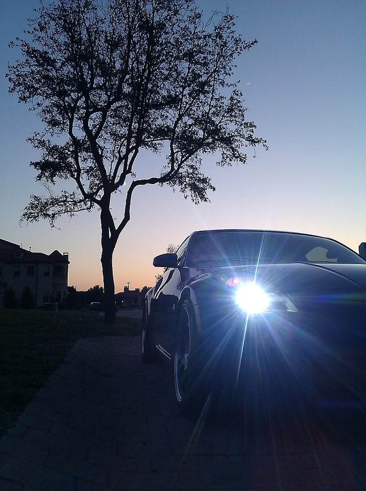

Here's what mine looks like with the KW V2 and camber kits:
The car doesn't sit perfectly level if the spring perch levels are the same left to right. With that in mind, the rear is about as low as it can go (not much more of a drop compared to Hotchkis springs). The fronts, however, can go much lower - I'd say 1.5" or more. 245/40/18 and 285/40/18 tires.
Hope this helps.

^ ^Thanks for the pics! So it looks like you can't quite get the top of the tire flush with the top of the wheel arch in the rear, yet you would be able to tuck your front tires?

You'll be able to. Depends on how much gas you have in the tank, and you can also remove the rear adjustable perch to be at the lowest drop. (This is my experience with 285/35/19 with 19x10.5 +15, -2,2 camber) I was able to tuck a little more than 5mm of the tire.

My rear tires ARE tucked in slightly (see side profile pic) and that's with less than full tank of gas.
If you remove the perch, then you take away the ability to even out from side to side. As stated above, when I tried the same perch "height," the car didn't sit perfectly level.
