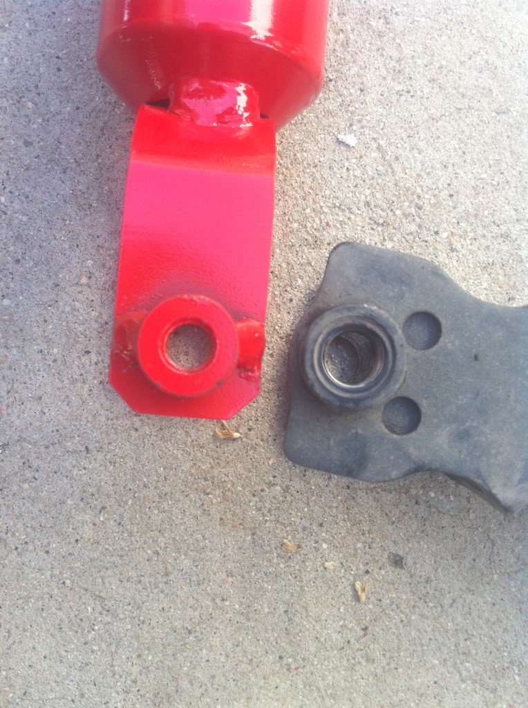

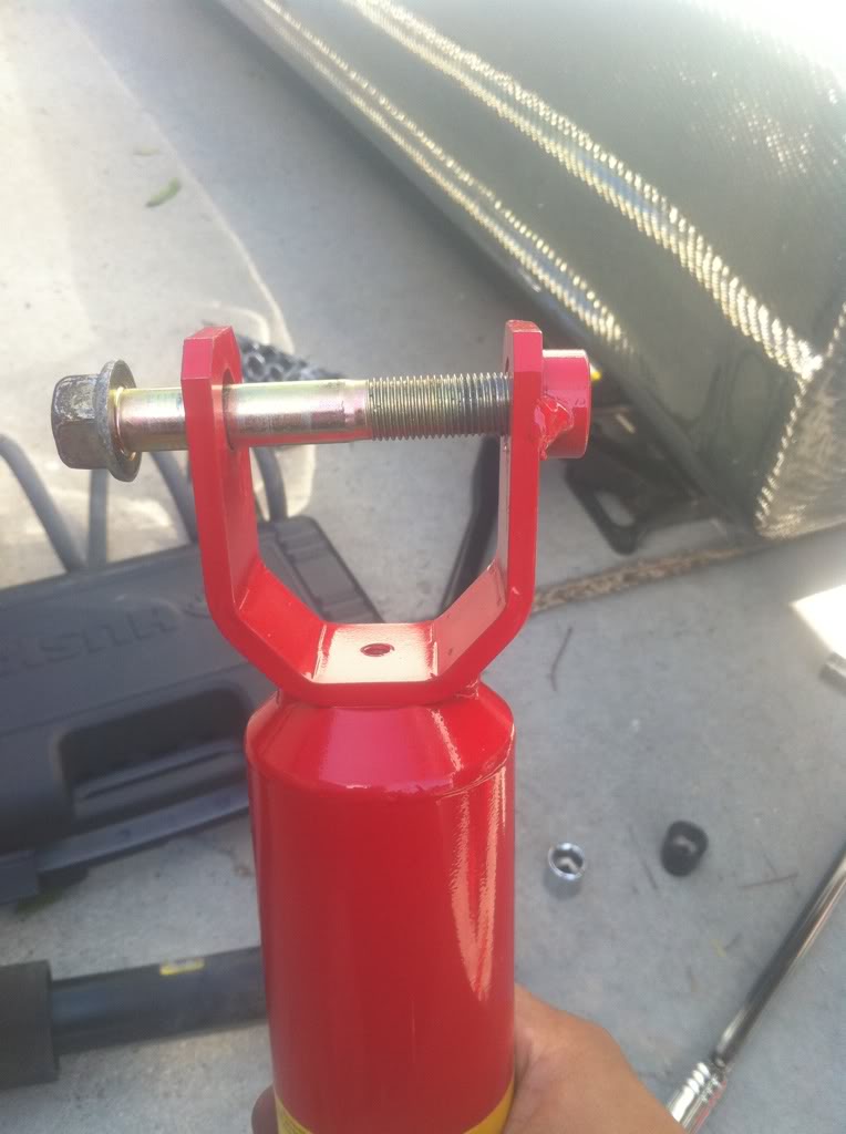

I've had these on my Z for a while now. I didn't notice much of a difference from stock suspension( a little more bumpy but not much). Im not slammed but I'm sure these have enought room to do that if I wanted. I did have a problem with them though. On the rear strut mount(lower part) the nut that was welded on was too small to reuse the oem bolt.
Example:
Couldn't reuse oem bolt here

Notice the nut is just a tad bit smaller than oem

This was as far in as it would go(wouldn't even thread)

I just called up F&F, explained, and they knew exactly what I was talking about. They said they were aware of the problem and it has been fixed. I guess mine were one of the last few that slipped out
So they shipped me new ones(only took 2 days and I didn't pay for shipping) and those bolted up fine.
