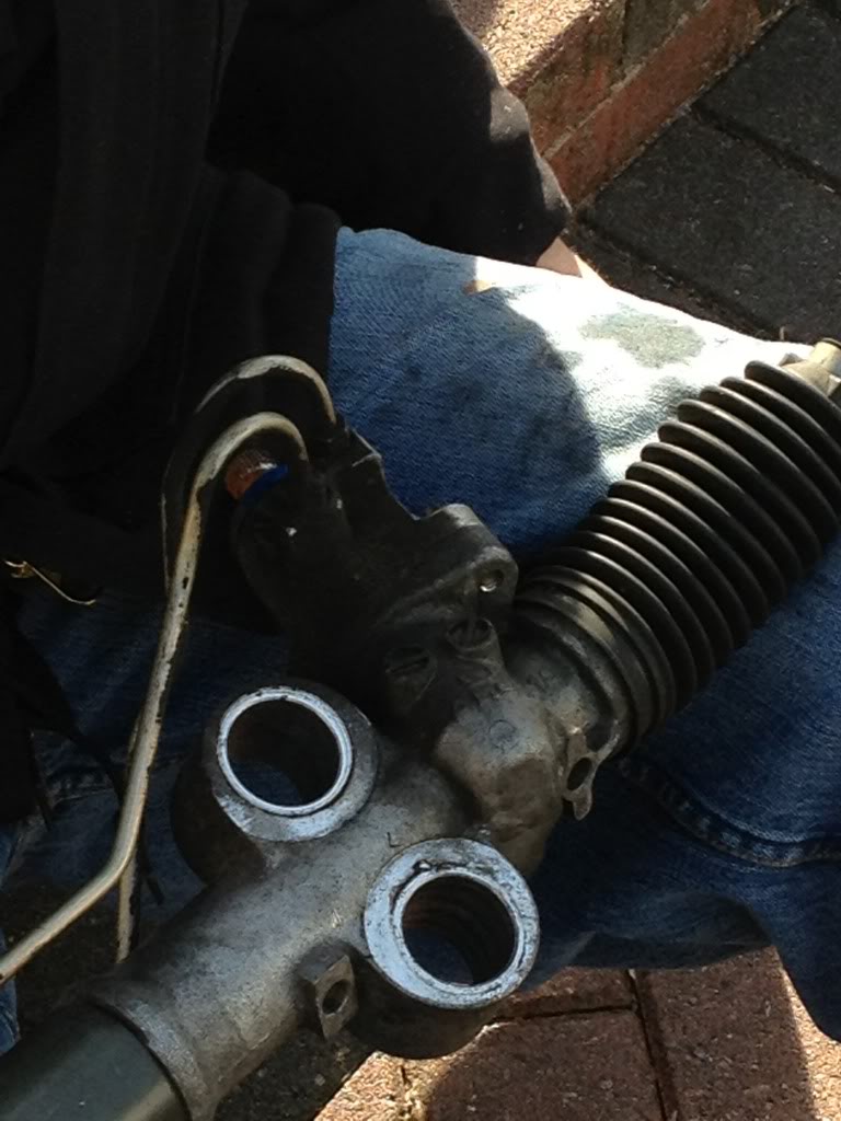

I did this today, along with Tein inner and outer tie rods. The install was pretty easy since the motor is not in the car. I still had to remove the hydraulic lines (which wasn't bad at all since I've long since drained my power steering fluid system). After removing the rack my buddy and I were able to literally hammer out the old steering rack bushings with a socket and a hammer.

Got all my front bushings and rack bushings installed yesterday.
Pulled the rack and used the shop press. Rack bushings came out very easy.
One gripe about oem and ES bushings. The ID of the metal sleeve is about an 1/8 larger then the bolt going thru. Allows for a lot of slop before torquing down. I did my best but ended up skewing my alignment buy about 10 degrees at the steering wheel. May turn some SS sleeves with a slip fit to remove this issue.
