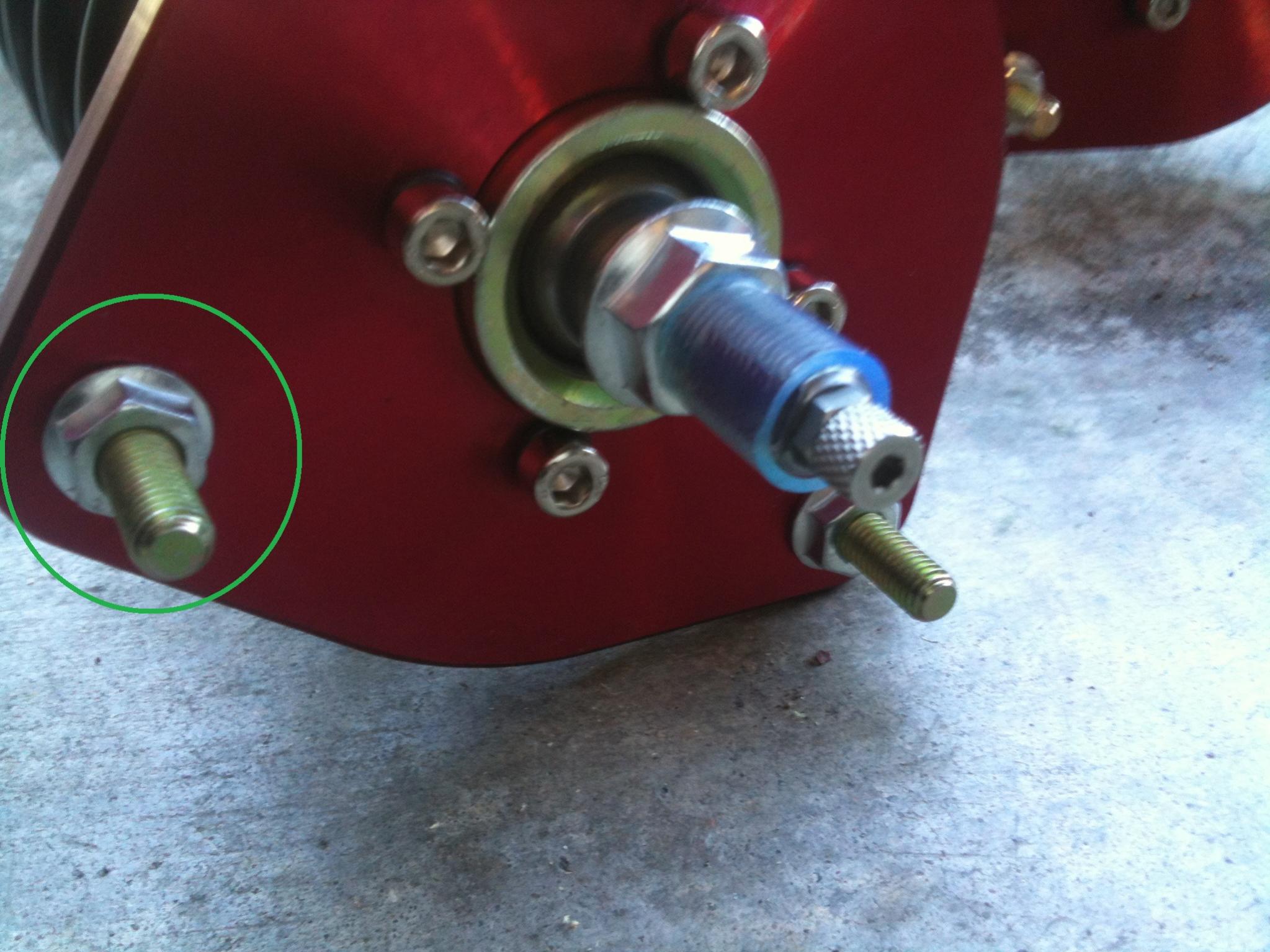

This may sound dumb but I actually left the front damper nuts (3 on top) on and installed, then realized and noticed that the struts came with nuts..
check from under hood if you didnt remove already, you will see a larger gap inbetween
funny I tought it was part of assembly..

That would definitely be a problem...
BTW, clunking sounds are usually the upper strut mounts.
