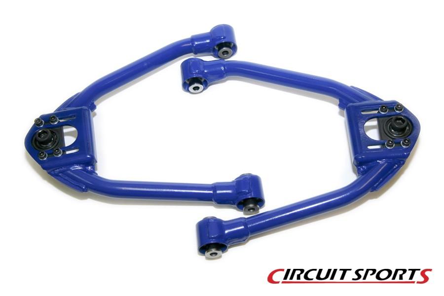

Does anybody have this? any feedback would be great. they look pretty legit.

They look great, i know they make some qualityish products. They are probably better than most till you get up to the SPL Parts level.

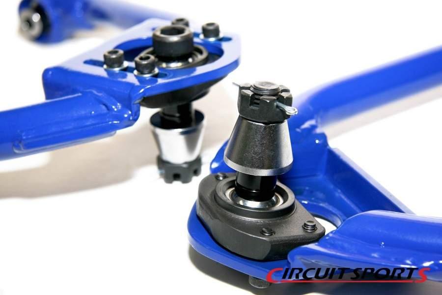

Are those sealed bearings instead of rubber or poly bushings? I don't think I've seen that before. Seems pretty legit.

They are a solid bearing design, we don't know the quality of the bearings , also let it be know they will probably make more noise than the typical rubber bushing arm. Last part, the arm seems to be a copy of Cusco, with addition of solid bearings. It is a proven design.
Circuit Sports seems to offer some qualityish parts. If I was in the market for a non caster adjustable arm to be used on a car that is tracked or drifted , I would have no problem trying these out.

^i was gona say the same thing, they look very similar to cusco (nevermind the blue paint lol).

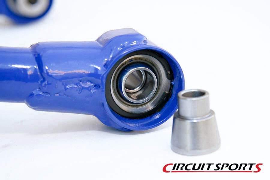

The only thing I'd prob be worried about is the camber slipping back out of spec. It only has 4 bolts that hold in place and there's no metal in between them like cusco. They look pretty good though.

That last pic's weld looks like a monkey did it..
