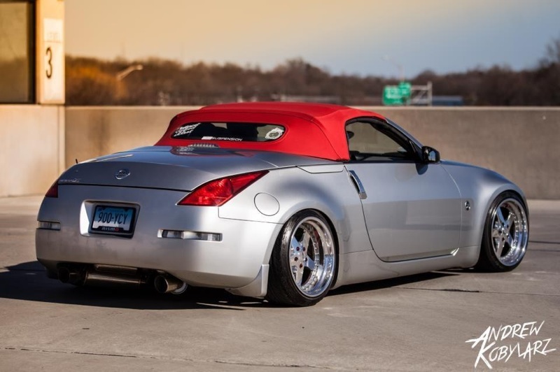

-3 at ride height no idea what it is fully airred out but my normal ride height isnt slammed either I live in CT cant ride around airred out all the time without completely destroying the car. Heres a pic of my ride height there are pics of it airred out in my garage album thing.
