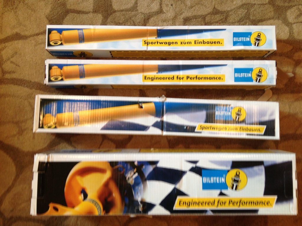

The shocks are Bilstein's Heavy Duty Dampers and they are a rebuild-able/revalve-able monotube style shock. In case you don't already know, Bilstein is arguably the best name in damping and they are proven over many different race series and repeatedly used in OEM performance upgrades.

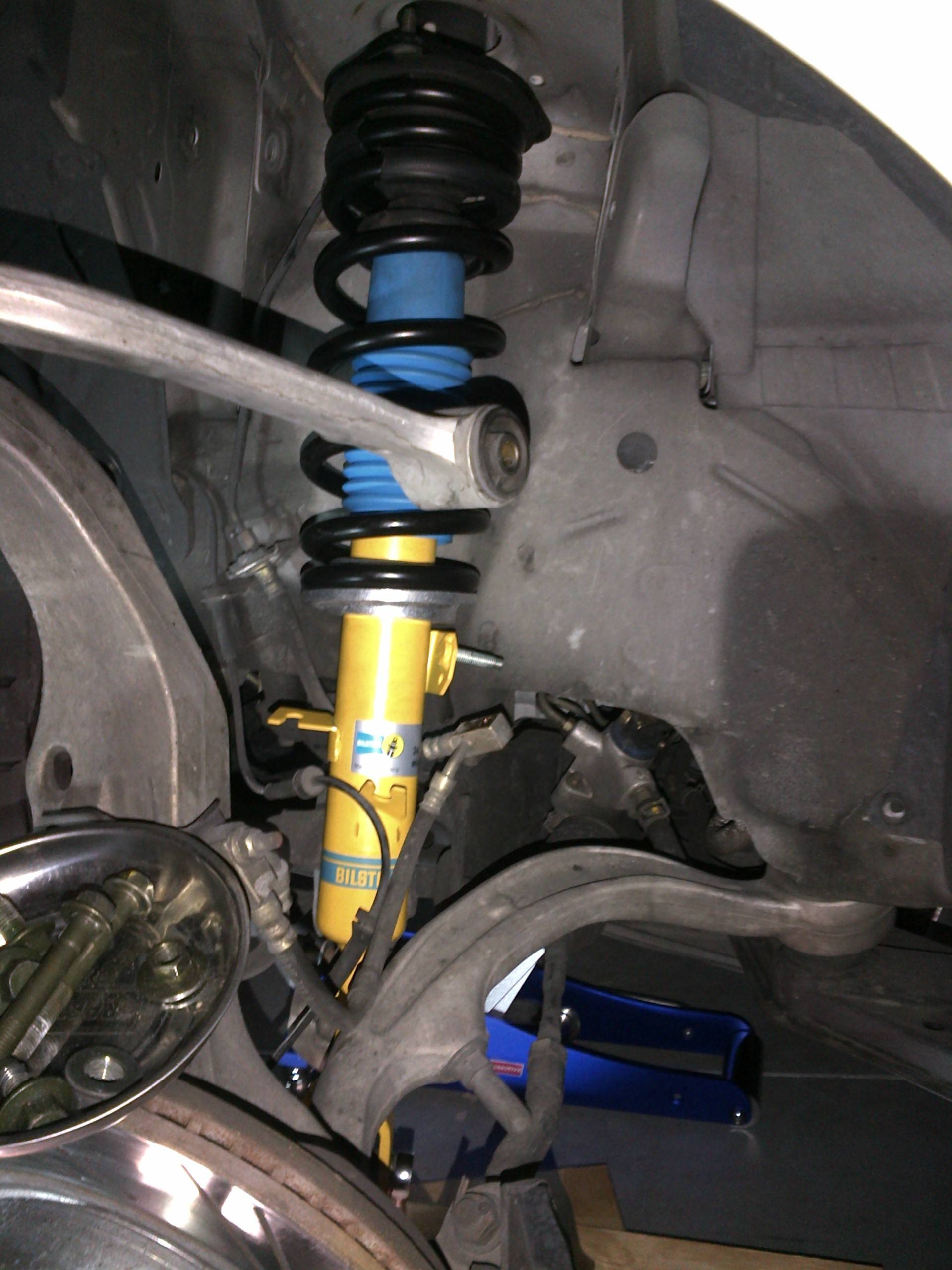

Now, onward to the installation. Everything is very straight-forward and there are plenty of youtube walkthroughs as well as write-ups on here that show you how it's done so I'm going to skip that part. The entire installation took about 5 or 6 hours including dinner but give yourself a weekend just in case you run into any troubles or don't want to rush through things. Here's what the front looked like once I had the shock/spring mostly in place:
