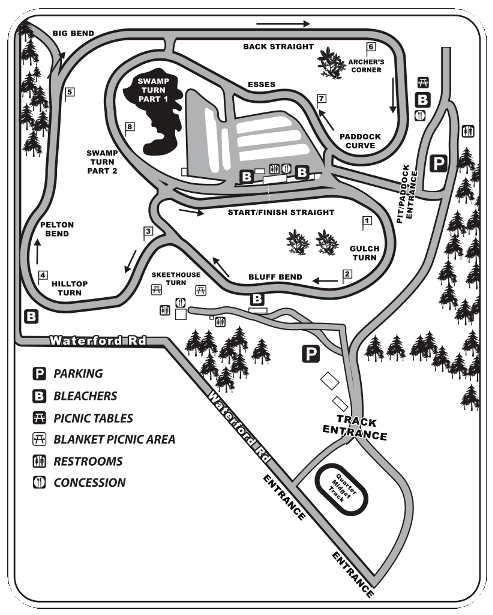

Worth mentioning that I do like how this combo feels on the rest of the track. The typical 90 degree corners, double-apex, etc.. Have you been to Gingerman or Waterford Hills yet?
turn 4 at Gingerman - after I apex there and want to accelerate out - the car just doesn't feel settled after the apex.. it just seems to hang out there and feels like it will let loose if I give it more throttle... by the time it feels settled, I have to brake for turn 5. Could be my line - I don't have too many track days out there.. but I can't be THAT far off to induce this unsettled feel.. in my opinion.
the kink at Waterford (after hilltop-turn 4, before turn 5) - same thing here. I have a lot of track time out at Waterford - so I am less likely to blame my line here (but still possible - I'm no pro).
and maybe my 'feel' wouldn't translate into a spin if I gave it gas - but not something I want to test going 70+ (especially at Waterford).
We can take this offline if you want. Not sure how far off-topic I am getting here. I just wanted to provide my feedback on this setup.
Attached Thumbnails Bilstein Shocks + Swift Spec-R Springs Review-gingerman-raceway-spec-map2.jpg   Bilstein Shocks + Swift Spec-R Springs Review-whfacilitymap.png

I see what you're saying - that feeling can be caused by just about anything. Too much camber or not enough camber can cause you to have less tire on the ground and feel less stable in a straight line or in a turn, respectively. Changing tires could mean softer or stiffer sidewalls, giving a completely different feel and cause it to feel unsettled. Lastly, the shock/spring combination could potentially be over or under damped causing the suspension to not travel or the car to undulate.
Another sensation that I've noticed is that we often do things to make our cars faster, then complain that it doesn't feel as "settled" or comfortable but forget the fact that we're going 5 or 10 mph faster through the same corner. You increase the maximum grip and the breaking point is more severe.
As for you're exact setup, the fact that you noticed this specifically after changing shocks/springs tells me that you may have gotten by with a setup prior that may not be applicable now due to differing spring rates.
Cobb: 436/535
Swift: 420/460
So the swift springs are definitely softer, however, that's not necessarily a bad thing. Try softening up your rear sway one link - this will give you a bit more traction in the rear and help it settle. Good rule of thumb is as follows (courtesy of tire rack):
