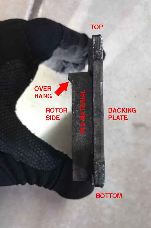

Digging up this old thread because my Akebonos were squealing like a stuck pig in heat riding on a train. The reason: Hawk pad overhang.
In the past I've run EBCs without issue (track and street). I switched to Hawk HPS+ and they were OK at first then started screaming, squealing and grinding horribly after only 4 months, 1 track day and 1,000 miles. So I removed front pads and found the problem: the Hawk pads sit TOO high on the rotor and thus overhang. As you can see in the attached picture the pads have a lip or edge on them. Inside of contacting the rotor flush they sit too high. As the pad wears the overhang starts grinding on the rotor's edge making all kinds of horrible squealing sounds.
There is a reason why CZP sells special pins for these brakes:
These upgraded caliper pins are used to improve pad contact on particular pads. We've noticed that some pads, especially Hawk, will have slight overhang compared to other brands. These Pins will allow the pads to site down lower and fix the overhang issue.
https://conceptzperformance.com/czp-...-h_p_30107.php
For now I just grinded the overhang off (dremel tool to the rescue!) but as the pads wear the lip will return unless I get the pins linked above. Honestly this is pretty shocking and disappointing from Hawk. They clearly put the holes in the wrong place on their mounting tabs

I just pulled mine off and found the same thing a couple Weekes ago. Except mine were Carbotech. Maybe it's something with the BBK and not the pads themselves. I just dremeled mine just like you did.
