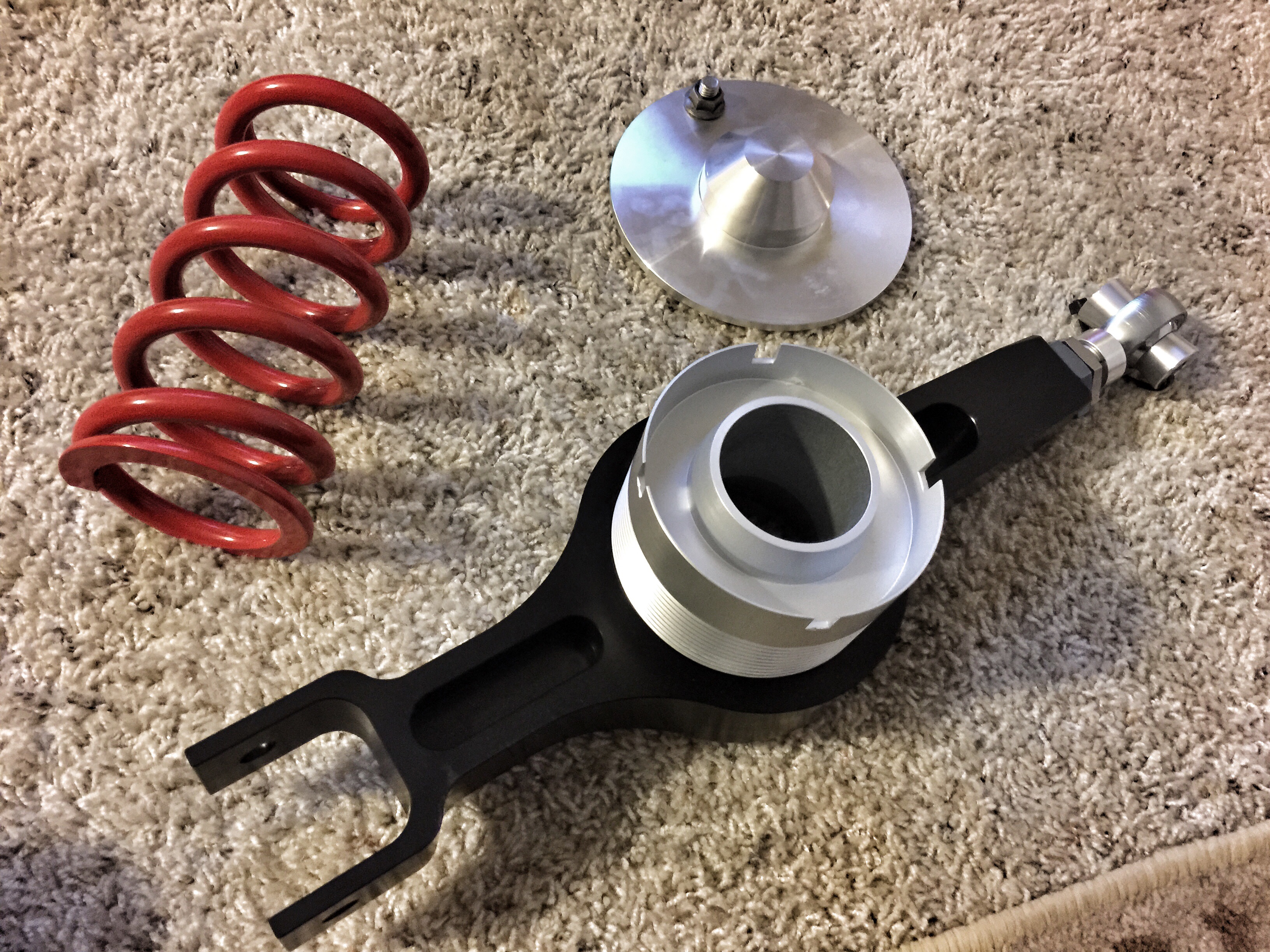

The arms came in over the weekend and my springs came in today straight from Summit. I chose to go with Eibach since I just could Not justify spending an extra $50 for Swift. I'm not good enough to tell a difference anyway. The machine work is truly flawless. I'll be installing them Thursday and getting the alignment Friday. I'll post the results!
DesertSleeper: I feel you on the cost bro. Trust me it wasn't a easy purchase, but it will be well worth it in the end.

So got everything installed this morning. SPL didn't supply any instructions but it's pretty straight forward. All in all it took me about 2 hrs, and that's with multiple adjustments eyeing the toe. The only problem I came across was the ride height.... With 7" springs and the buckets at the lowest position I still have atleast a 1 1/2" wheel gap. So I'm sending those back to Summit and I'm going with 6". Other than that I'm pretty satisfied. Just from a visual inspection I can tell that it fixed the toe issue and I still have more room to play with.

Those are some good looking midlinks brother, SPL eye candy right there.......
