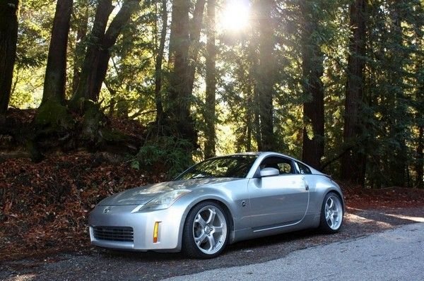

I'd go ahead and lower the car with Pro Kit springs (or Tein or..... something that lowers the car between 0.5 and 0.75") - a conservative drop but effective and for the most part, won't require camber/toe hardware.
For perspective:
Slightly less than 1" drop. Eibach ProKit

Originally Posted by MicVelo
Well, definitely the proper sizes.
For perspective:
i noticed in this one you have slightly more clearance than my silver does in the rear. explains why im rubbing....

Originally Posted by Ace2347
So if I do 1.5 i will need to get new shocks also?? OR an 1inch is the lowest before having to buy anything else allong with springs??
OP, as it's been stated by Trav and others, the stock shocks will *likely* need to be replaced sooner than later. Simply due to the shocks having to work harder to keep the stiffer springs in check. More work = more heat = more wear.

T'bo, in that shot, just put the wheels on with spacers out front ONLY (had to use 'em due to the high offset of the Z34 wheels). I've since installed a pair of 15s on the normally +30 rears. Hella-toilet-flush.
But still no rubbing.
Sheesh, for a guy who hates spacers, sure do have a lot of 'em sittin' around my garage.
