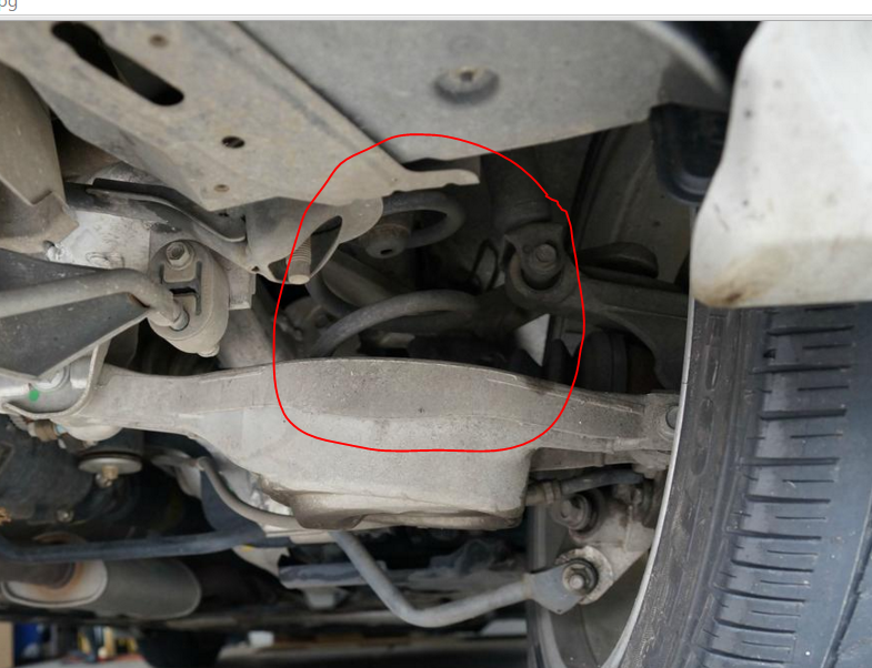

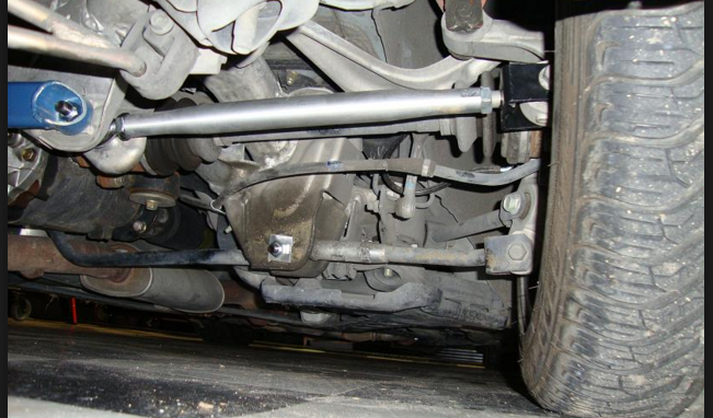

you would need to crawl under it... look at the spring bucket, is there something in there?
does it look like pic 1 or 2?

OEM location
