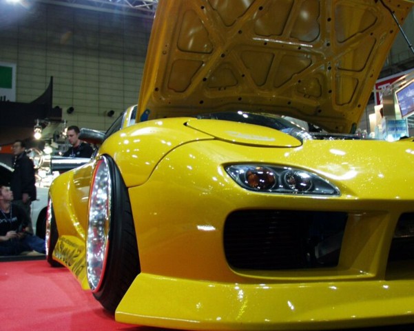

Originally posted by ssk0771
Are you sure? I want to make sure.
If anyone has a pic of mounting 245-45-18 on 18x10.5 please post some pic.
Thank You.
i imagine it would look something like this.. ok maybe not this extreme

SSR sometimes uses high & low surface mounting pads and it looks like this is what caused the issue with the above said car.
PLEASE do not put a 245 on a 10 or 10.5" rim. It can potentially be a serious problem. I cant believe someone would risk ripping the tire off the bead by Drifting with that setup.

Todd is absolutely right. The maximum allowable rim width for most 245 tires is 9.0"
If you're going to run an 18x10.5 on the rear, you are sort of "stuck in the middle" when trying to match the diameter of the OE 245/45-18 tire (26.68").
A 285/40-18 is 26.97" and a 295/35-18 is 26.13".
