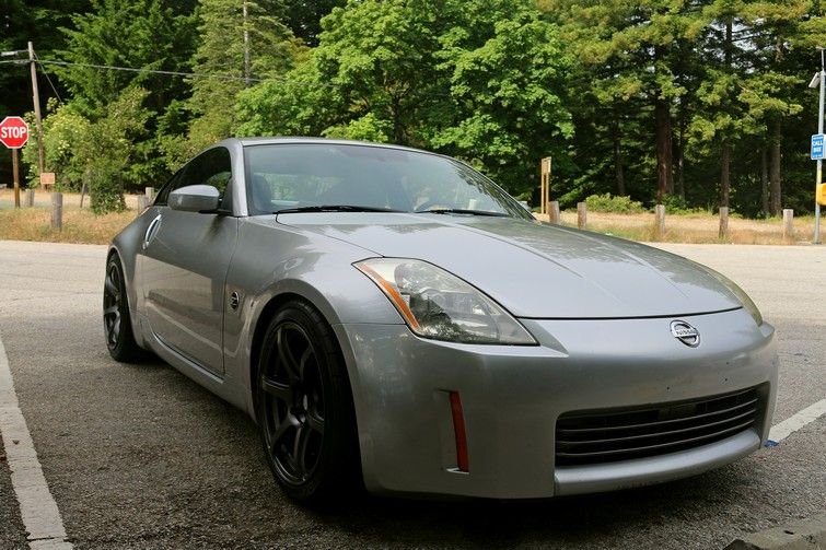

OK, well, if this helps, a pic's worth a thousand words...
My '03 on ProKit/Koni Yellow.
The springs have settled after 3 years to an almost too low -19mm.
And now, with a set of Nismo size tires (18/19 setup described here: https://my350z.com/forum/wheels-and-...-find-out.html ), my exhaust scrapes on medium grade driveways and speed bumps. Feh.
