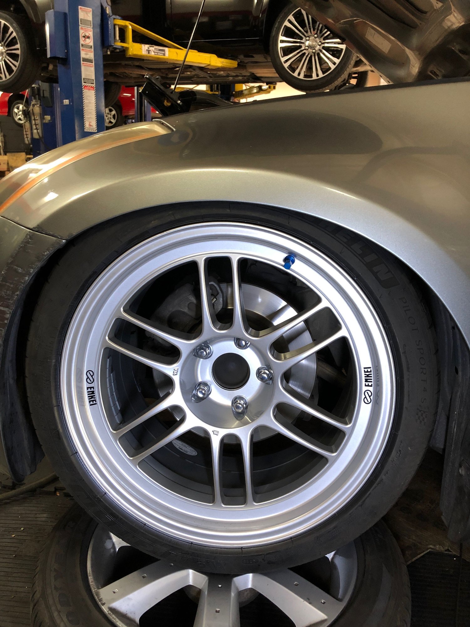

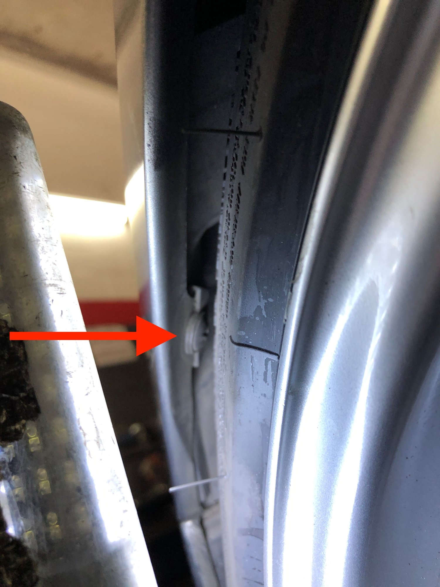

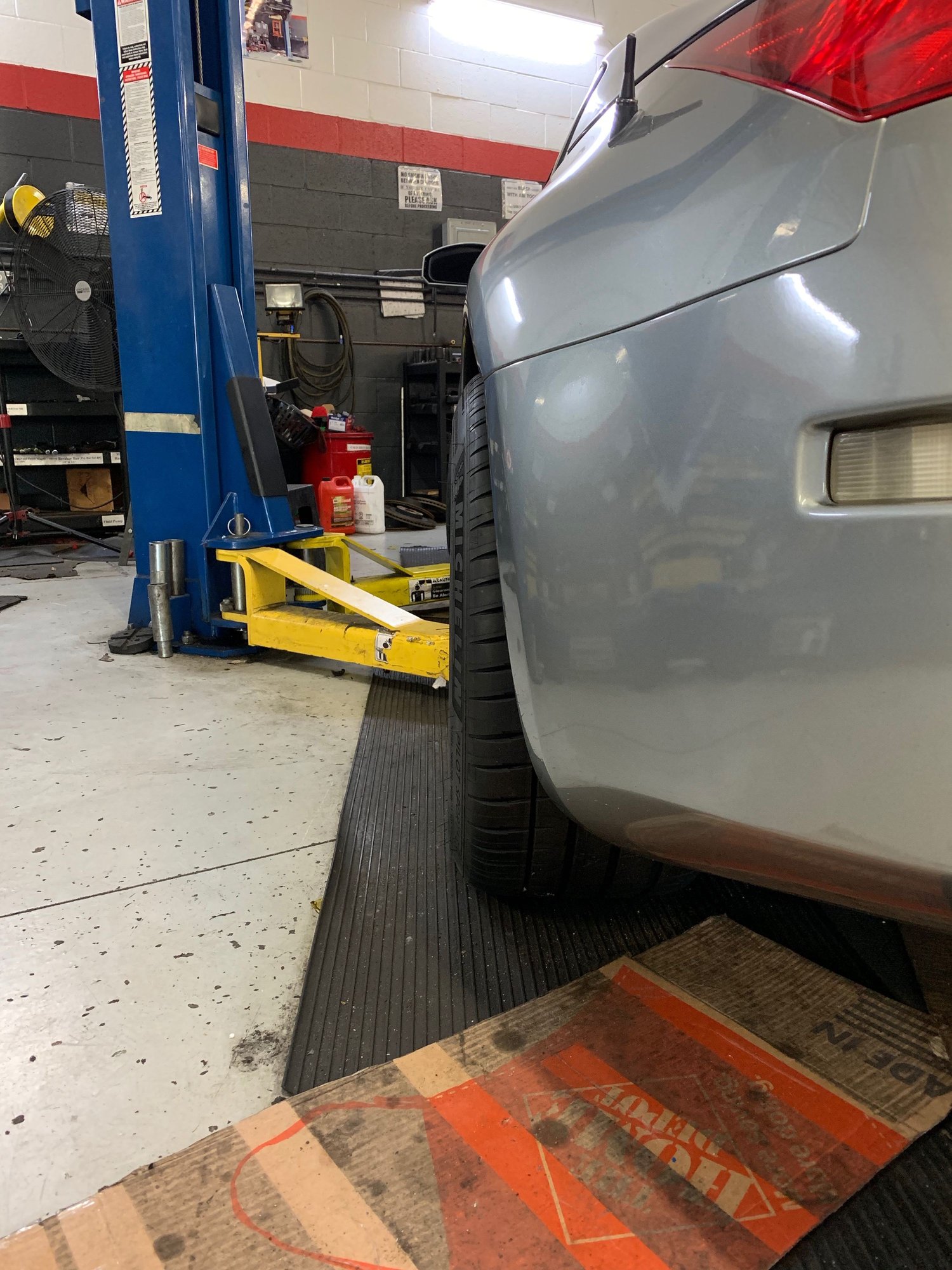

I've also done a 18x10.5 +15 RPF1 (275/35ZR-18 MICHELIN PILOT SPORT 4S) on all 4 with stock suspension (for grip naturally!). On my Zed, even with quite a bit of camber, the rears touched the fenders when compressed far enough. You can test this by removing the front and rear suspension and pushing the wheel up into the fender. I rolled the rear fenders, but was unsure what to do up front since the fenders are already rolled from the factory. At full compression the fronts didn't rub, but if you turned the wheels they would. I settled on removing the fender clips (red arrow) bending the fender tab back by hand and using a zip tie in place of the fender clip. So far it's worked! I saw a photo someone took of me an autocross that showed the outside wheel at full tilt and it's really close to the fender, but no rubbing as far as I can tell.
