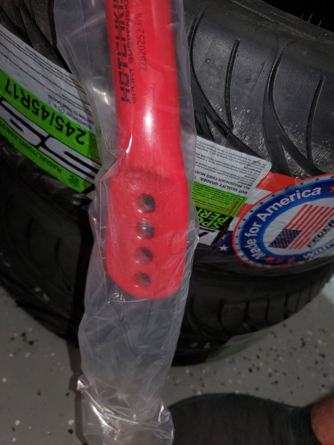

For those that run the Hotchkis bar, it looks like it has five adjustment settings. Which one do y'all use?

My bars have 3 holes as I recall. I run on the softest setting/closest to the end for street use. If I'm driving hard in N Ga or NC mountains my lip will scrape on hairpin turns so I may go to the middle/medium setting this Spring.

Front: Hole 1 of 4 (towards end) = softest
Rear: Hole 2 of 3 = Medium
This setting is biased towards mild oversteer. I started with full soft F&R (which is already stiffer than stock), experimented with what I like all the way up to full stiff. For my type and style of driving, I like the above best for street/highway, hills runs. YMMV. I always recommend this method of testing to see what works best for YOU.

Bars here!
Install will be Saturday morning

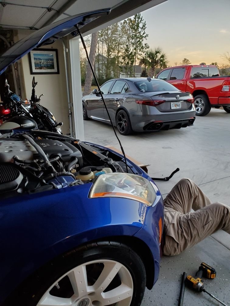

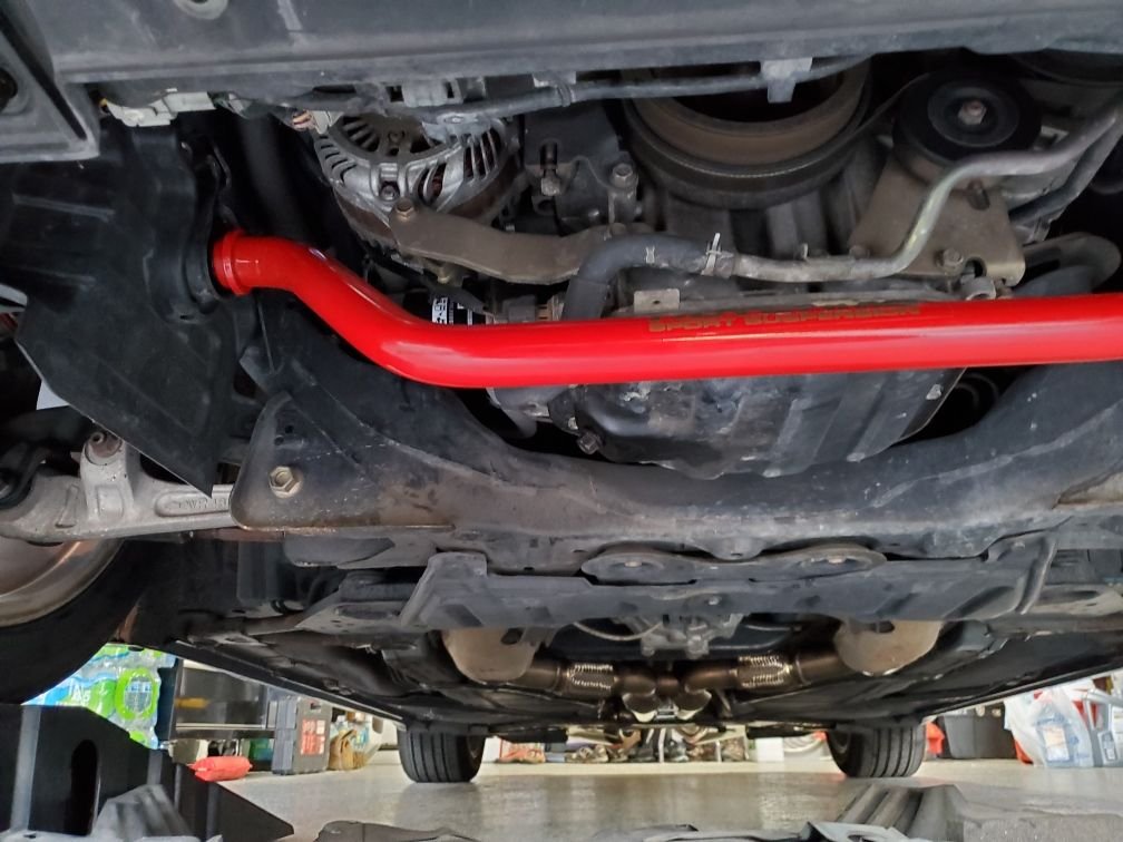

Swaybar is on. Took about 45 minutes from wheels up to wheels down.
My size XL *** under the car.
