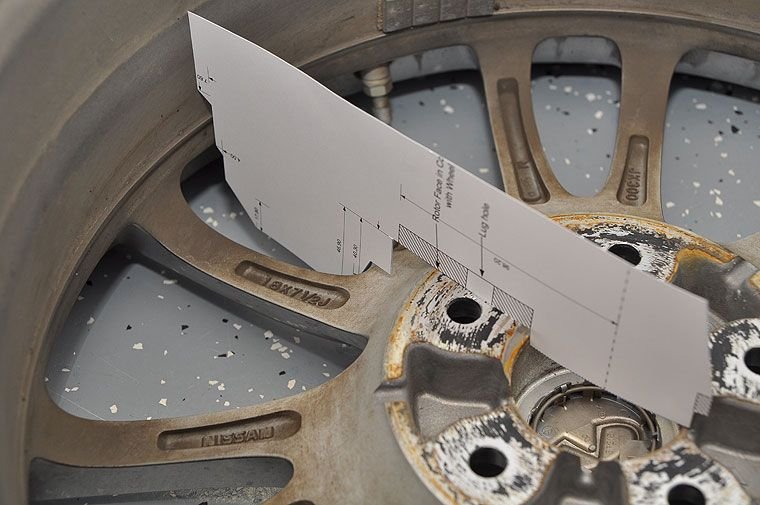

There are far too many wheels that will and many that won't work. This is what you need to properly shop for wheels to use with the Akebono setup:
Make the templates on your own:
https://conceptzperformance.com/item.../docs/file.pdf
https://conceptzperformance.com/item...cs/57_file.pdf
Old Feb 8, 2021 | 09:06 AM

Just speaking from personal experience, I have some Touring V2 18" wheels that I put on my Z in the winter time as "rollers." They fit but it is extremely tight. I had to knock off the stick-on wheel weights on the inner barrel because they were coming into contact with the Akebono caliper. I also test-mounted the double-stagger 18"/19" Nismo wheels on there and the 18"s on the front would catch a small part of the caliper and prevent it from spinning freely. As Mic mentioned, you can put some spacers on there so that the part of the barrel that hits the caliper gets pushed away from the caliper and solve this problem. Or, you can grind off part of the caliper, but I chose not to go that route.
However, not all 18"s have the same inner barrel design. So, while some 18"s will fit (like the popular RPF1s), others will not based on the design of the barrel. It's best to download the aforementioned template and try it out on the wheels in question.
