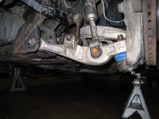

My 2005 coupe has ~137k miles on it now and I am replacing the front lower ball joints and lower control arm bushings. I'm replacing the ball joints to hopefully cure the last of the front end clunks that I have. The clunking is over bumps, and very pronounced when coming to stop at slow (parking in the garage) speeds. From what I read elsewhere, that seemed to point to the lower ball joints.
I went with the Mevotech lower ball joints and have ordered up the Megan Racing bushings. I didn't want to go with urethane bushings as this is a street car, and although I may try a track day at some point, I wanted to keep some of the compliance in the bushings by sticking with a rubber part. The Megan Racing part seems to offer a durability improvement, while still keeping some complaince of a rubber part.
I started on the driver's side last night and one issue I ran into was that the nut for the Mevotech ball joint is not very tall, so it does not allow easy purchase for a socket or wrench. The nut sits down in the opening of the control arm, and none of my 24mm sockets will get a good grip to tighten it. I wound up haveing to use a crescent wrench and I did get it tight...but I'm thinking of taking it off and adding a stainless or Grade 5 or 8 washer underneath the nut to give a little more height and clearance so that I can tighten it down with a socket. There would still be clearance, even with a washer under the nut, to allow the cotter pin to be installed.
Has anyone else run into this clearance issue to tighten that ball joint nut?

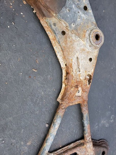

Just to close this out, I spent the day yesterday replacing the compression rod arms and front & rear underbody braces on the Z. The new ball joints in the new compression rod arms did the trick and the front end clunk is gone! I put about 170miles on the Z today and it was great! So quiet and tracking so smooth!
Some pics of the work yesterday are below. The rust was really bad on the front and rear underbody braces. This was after 142k miles and the previous owner driving this Z through MI winters. The rear underbody brace folded in half like a piece of paper! I used new braces from Ultra Racing. The compression rod arms were from Mevotech (via RockAuto). Two bolts (one in the front and one in the rear) had to be drilled out and have the threads re-cut. Fotunately, I had extra bolts that I had taken from a "parts Z" that I grabbed some items from last Summer - it was a low mileage convertible that had never seen Winter, so I pulled a bunch of extra bolts to have on-hand for things like this...wish I had grabbed more of them!
