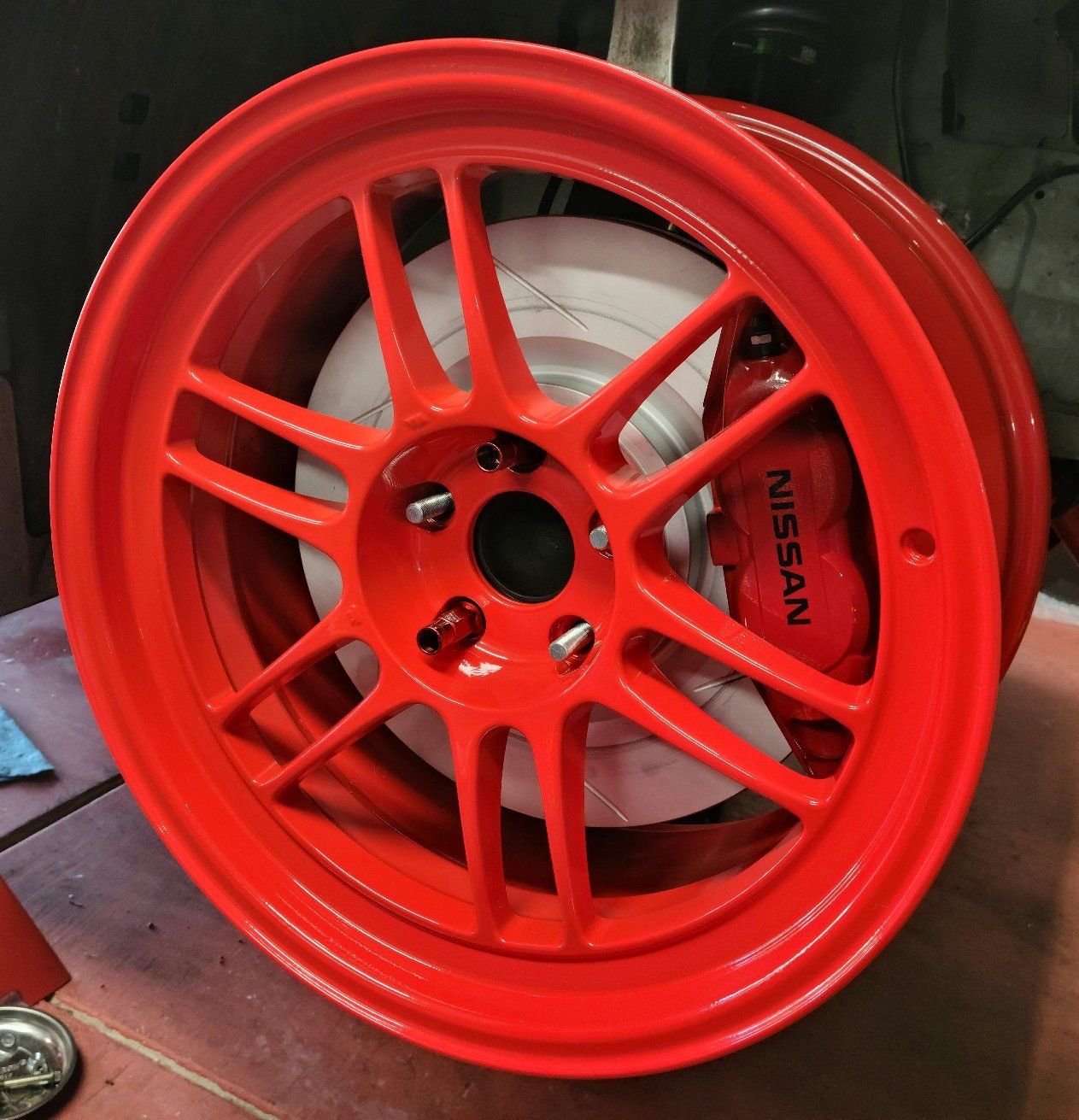

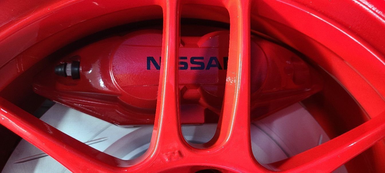

Enkie RFP1 18s would not fit over the akebono calipers. looking back on it now, I probably could have used 3mm spacers but I didn't think about it at the time. I switched to different wheels.
