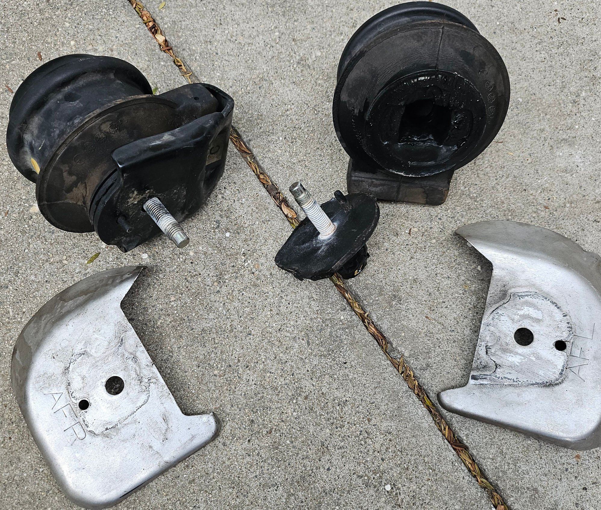

Update. So I confirmed that one or both the motor mounts are shot. Most likely the driver side. When revving the engine on neutral there was not much flex on the motor. I chaulked the wheels and applied the parking brake on. Put it in 1st gear and put some load on the engine and sure enough the motor lifts up and does hit the strut brace. So motor mounts it is.

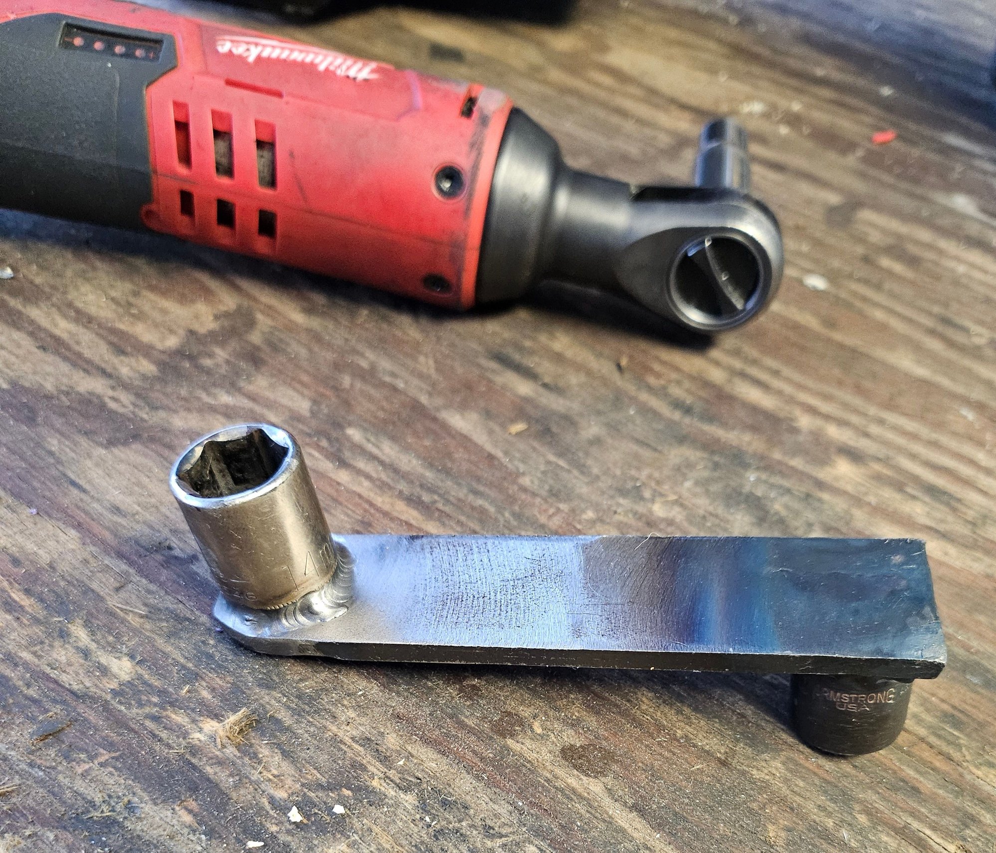

So got around to replacing the motor mounts this weekend. WHAT A PAIN IN THE ***. Getting to the top nuts was a challenge but breaking them loose was the real challenge. I read that the passenger side was the most challenging so that's where I started. Got that nut loose in about 15 minutes tops. I was like man this wont be as bad after all. So now I go over to the driver side. Nut is completely visible so I thought this should be quick.... WRONG I fought and struggled on the driver side. Ended up taking off the heatshield from the exhaust manifold which is only 4 bolts but man was it challenging to get that shield off.
Anyway got the shield off to give me more room to work with. I struggled and battled to get that top nut loose for about 4 hours trying different approaches and different tools. I finally made up my own tool and thankfully it worked. Got the nut loose. Lifted the motor up. Slid the old ones out and new ones went in like nothing. Got the nuts back on on top with no struggle.
Driver side mount was completed torn.
What i strongly suggest is use only a stubby 14mm wrench that's 6 point only. If you dont you WILL strip the nut and then youll have a real big problem or you can make a tool like I did with a 14mm socket 6 point. This only worked for the driver side.
For the passenger side i used a 14mm stubby wrench and used a bar for leverage to break the nut loose. There is no way to get a socket on the passengef side nut. I would also strongly recommend using a 6 point stubby wrench. I know some some people take off the mount bracker unbolting the 4 bolts from the block and then taking the top nut off but I didnt have to do that. You can definitely take the top nut off from the passenger side without removing the bracket. Taking off the oil filter and alternator gives you enough access to get the passenger side top nut.
