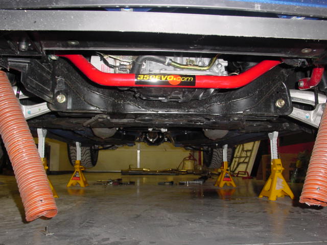

I was lucky enough to pick up a used set of 350 EVO Sway bars with poly bushings from JasonH a little while back and would now like to comment on them after having driven with them on for a little while.
Install was really quite easy and took about 90 minutes only because I have no air tools to work with. With air tools I see this taking 30-45 minutes. The rears were very easy with fewer bolts to remove and retighten. There is only one trick on the front and that is to remove the connecting rod at the end of the sway bar completely and flip it upside down so that there is enough bolt to actually go through the sway bar to be installed.
I initially just installed the bars with poly bushings with no teflon tape or antiseize, but found out the hard way and very quickly that it is very annoying and makes more noises than the interior on a bad day. After adding some antiseize to the bushings the noises disappered and all is well.
Does anyone know where I can get a good deal on a harness bar with harness setup? I set the front and rear to medium stiffness and all I can say is that the car is now very planted but I feel I might need that harness to stay in my seat I can honestly take turns and corners like never before with great control and no hint of the rear wanting to come out on me. I think my wife is now scarred to ride with me because I want to see just how fast I can take my usual corners. I currently have the stock springs and struts, but have the RSR Ti springs on the way which will really make things interesting. I do have LE37ts with Toyo T1-S 255/35 fronts and 275/35 rears which do help a lot. I couldn't be happier and feel that I was very lucky to pick up this special setup from JasonH, thank you, for a great deal. I say special because this set is a little different than the rest I have seen. The attached is a pic on JasonH's car before being removed. I will try to get a pick on my car from the rear this week. Anyone see the difference

What kind of jack stands are those? The ones I have don't fit the Z.....

I do not know as the pic is from JasonH just before the sways were removed to be sent to me. He may be able to answer that question though.
