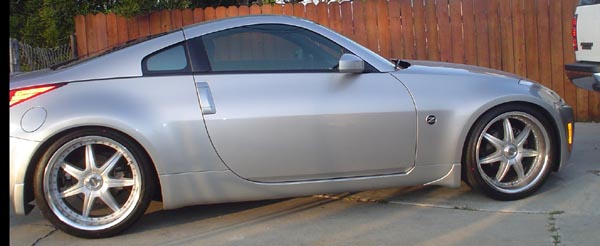

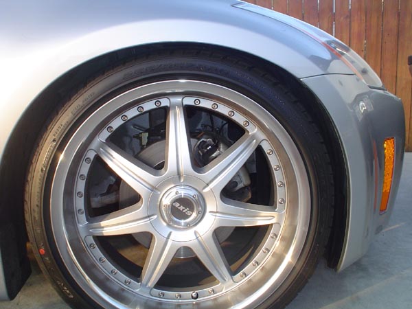

Here are some pics of install eibachs pro line 1 inch drop, with 20 inch axis mods. If you do the install yourself, dont buy the springs compressor, just wrap the complete strut and spring , wrap it tight in a old blanket( not a new one your wife will kill you) wrap the top of the pearch as well just enough so you can get a deep socket 17mm on there, dont forget to break the bolt loose with a closed end first and a crescent wrench to hold the threads hope I didnt lose you. You will have enough muscle to get the the new spring on and the nut on TRUST ME YOUR WAISTING YOUR MONEY ON COMPRESSOR SPRINGS IVE DONE 12 CARS i KNOW. Here are some pics the rear has about 100+lbs in amps sub and mdf so it might be just a tad higher if you dont have a custom stereo system in the back . here are some pics' Thanks Ernie

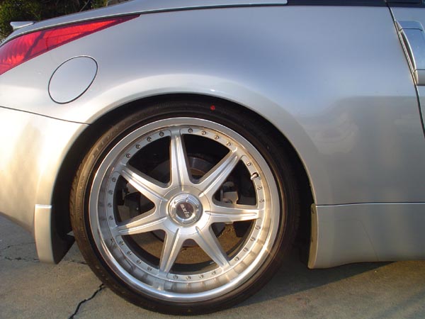

Default rear
rear

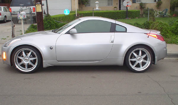

Default whole car
full pic
