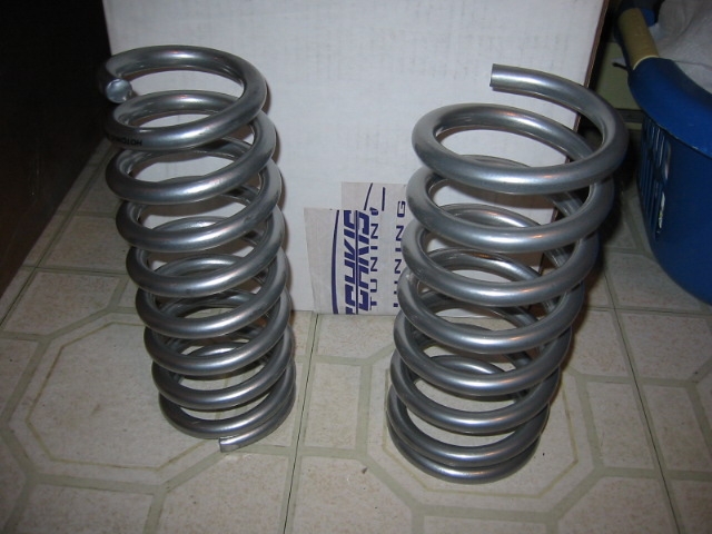

I'd like to see pics of the Hotchkis springs, can someone post pics of the actual 350Z springs please.

Left is front, right is rear.

Thanks a lot FritzMan
Man that looks like some think wire, wonder what the actual rates are in lbs.
So I think we've finallly found some true linear springs. If only the drop was a little bit more. Where's the cheapest place to get these springs?
