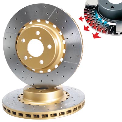

I would go with the pillar vane rotors that Stillen sells. Their internal vents are different from normal rotors so thay cool much better. They come in drilled and slotted or slotted only. It's the best you can get without going 2-piece or a complete brake kit. Also consider adding a set of stainless steel braided brake lines. These will give you firmer pedal feel.

Agreed with gporcsh. Stillen makes some good OE sized rotors with better vaning technology. Also Stoptech makes some really good OE sized rotors as well that cool better than stock. I think both the Stillen and Stoptechs will cost you about $100 per rotor. For the street you can get whatever you want regarding slotted/drilled or just slotted since you won't be doing any heavy track braking reapeatedly. Really your preference there. But for what it's worth, most track guys will say go with just slotted since the drilled holes compromise structural integrity a bit and is more condusive to cracking. Might as well do the stainless steel lines while your at and change to some brand of sythetic brake fluid with a hihger boiling point. The Valvoline that comes in the gold bottle immeidately comes to mind for an affordable synthetic brake fluid that will suit the street machine just fine.
