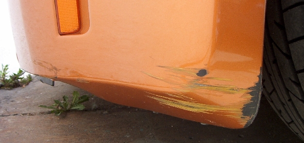

Sorry to barge into your thread like this but I'm desperate...
My Grandfather rubbed the lower front of the car in a curb and look at the damage.
DetailingDude, since you ofered to help ricky, maybe tou could offer some thought on my case too.
Is there some special kind of polish for plastic parts so i can take the yellow pait out?
For the section where the original paint was scraped completely off I was thinking of getting an airbrush (like those used for model building) and using the touch up paint (wich I already ordered from courtesy parts). What do you think of this?
Please help

Dude, don't panic!!! The yellow paint will come off extremely easily with 3M General Purpose Adhesive Cleaner. You could do the air brushing or you could give either Chips Away or AeroColours a call.

Thanks for the reply DetailingDude, but I live in Mexico and we don't have those shops here . I'm taking it to a suposedely specialized bodyrepair shop and see what they can do about it. Nevertheless I still believe my best chance could be with touchup paint and airbrush just need to get some help with primer or surface prepping instuctions, as well as aplying instructions . I suppose since I love my car only I will try to get decent enough results.

If you're skilled with an airbrush then I suggest that you order some paint from someone online who specializes in that sort of application. If you're planning on putting your own touch up paint into the guy you'll find that it is very high in solids and will clog up your gun.
Careful. I'm pretty sure your paint is a three stage paint like my Daytona Blue. There is a undercoat, a tint over that, and a clearcoat over that. That's why the paint has such depth and that show car like glow to it in the sun. Any touch-up paint you buy will likely be a lacquer based mix and it WILL NOT replicate the depth and glow (or even the color) of the original - even if you put clear coat on over it. You really need a body shop that can do the three step process or the results are going to look pretty sad. A two step touch up will look milky, have no depth, not have the diemnsional gleam of the original and probably will be off in color as well.
I have learned all of this the hard way in the past 2 days getting my new Nismo body kit painted. It can be done, but I don't think there is any way you can duplicate it (or even get close) yourself. My advice would be to drive how ever far you have to to find a good body shop.
