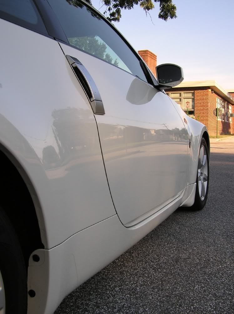

I don't know. 58,000 miles and I have never used a polish just a one-step. I can tell when the car needs attention because the surface no longer beads water.
David your car is white and hides a lot of imperfections as does silver.If you have a darker colored car you can very easily see swirls and imperfections.So the way to stop polishing your car to often is to refine your washing tecniuqes(spelling of course).
