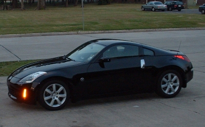

PS: Hey Chris with the Black Z! What do you have for your front markers. . . are they just clear, or clear with LEDs? I like the look
STOCK! haha the flash makes them look like they light up. Anyway, the lube is just some Zaino Carwash mixed with water in a HIGHLY CONCETRATED solution. There are directions that come with the kit too. But I claybar side to side not circular.
You will love your results! https://my350z.com/forum/showthread....688#post475688 <there's mine!

Very nice results. That's crazy that your sidemarkers are stock. They look white with the camera. Youd' think they'd light up orange with the flash.
Looks good :-)
Did you follow the instructions that came with Zaino to make your car look the way it does?
Hey! I just noticed your tail lights look clear too. . . is that the camera flash that's doin that? You do have red tail lights and orange side markers right? haha

LOL, that is a filtered image grayscaled and filtered khaki color. Here is the original. Yes, I followed the zaino instructions.

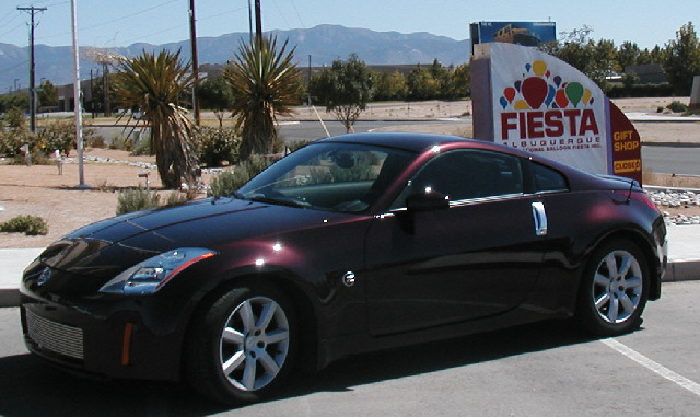

The bottles you get with the "ZFX" are you mixing bottles. The one with the blue lid is the vile of "ZFX". Your mixing bottle are 2 ounce bottles. Put something less than 1 ounce in the bottle and 3-4 drops. Don't squeeze the vile. Hold verticle and let the drops fall.
As far as time. Has the Z2 or Z5 with or without "ZFX" dried? With low humidity and high temps (not in sun) with "ZFX" could dry in less than 10 minutes. Without "ZFX", it might take 10 - 12 hours. I get a much better shine when I leave it on overnight. Wash the car late afternoon. Follow that up with Z6. Put some Z2 or Z5 with or without "ZFX" in the mixing bottle, apply, let in remain on your "Z" overnight and buff the next morning. Follow it up with Z6 and you are on your way.
Attached Thumbnails Zaino + Claybaring  :  MY FIRST TIME.   Please Help.-mod-2-z-pic-8-oct-2003.jpg
