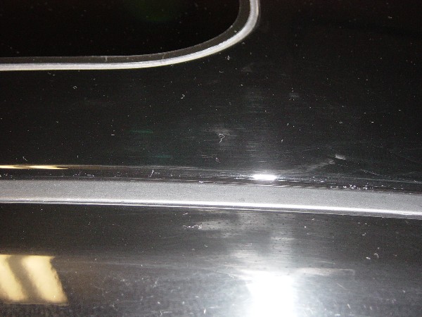

I have attached a few pictures, I realize they are not the greatest picture since it is dark.
The clay bar did start to break up, that is when I opened another clay bar.
The chamoise is few years old, been washed many time with mild liquid detergent and air dried.
I had been e-mailed to try bottled water, any other ideas?

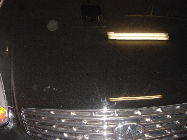

Another pic

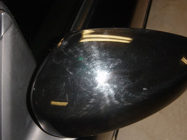

last

The ones on your mirror look like swirls. The others are hard to tell. You might have had some debris in/on your towel, your washmit, or your clay that did that.
You may need some swirl filler.
May want to show those pics to the experts over at autopia. They look pretty bad.

I think the previous owner or dealer ship is the one that has messed that paint up, it looks like old damage, I do not think you caused all of that with just washing and clay baring. I would use some 3M Swirl Mark Remover part number 39009 and my Porter Cable orbital to fix it myself before Z-5, but thats me.
