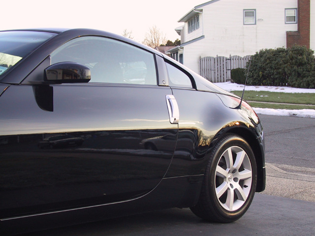

That's a good tip. Also, work from top to bottom when washing. This is critical on a black car. Dirt from the wheel well area will lodge in your sponge/mitt and swirl up the paint. I just finished my 3 coats of Zaino Z5, with coats of Z6 in between each today. I'm debating whether or not to even put on Z2 tomorrow.
