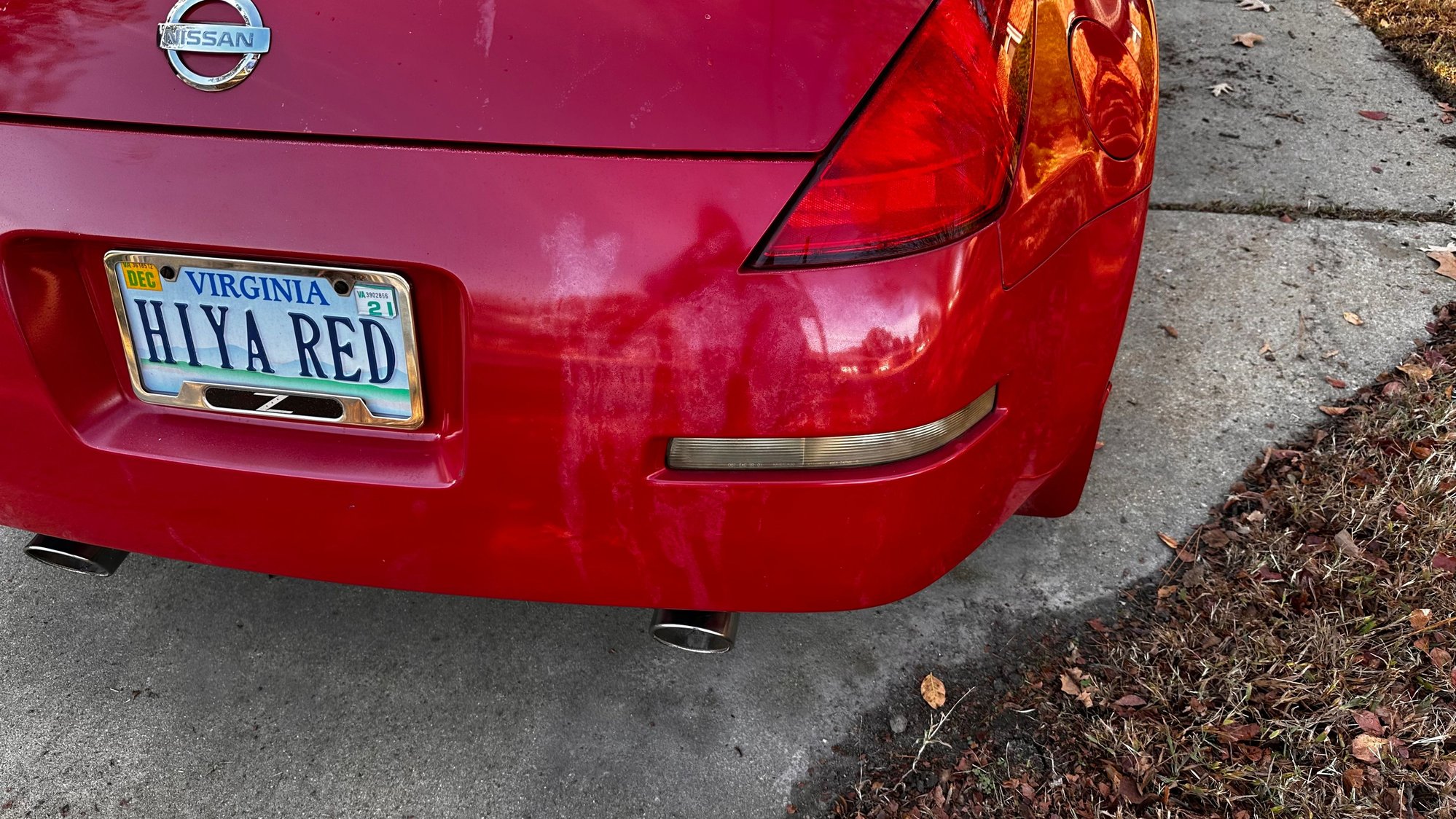

Hello Everyone, I really could use some advice. I have a 2003 350 Z touring model. The mileage is only 140,000 and haven’t driven the car in three years. My husband bought it for me brand new off the lot when we got married and I’ve had it ever since. Unfortunately, he passed in 2021 and I just can’t bring myself to sell it. I really want to keep the car but I think I made a mistake by taking somebody’s advice and bought a heavy duty car cover and was supposed to guarantee it for so many years I’ve had it on for six months and unfortunately it has ruined my car I think. i’ve taken the cover off and I have white oxidation spots all over it even on the vinyl fender parts I really could use some advice on what I should do, how I should do it, & where should I start….. Please Help

If you don't want to do it yourself, take it to a wash or detail establishment and let them go to town with it using their various polishes and power buffers. (Or at least consult with them.) It might not be true oxidation; rather, mold/mildew. (Giveaway is it's on the plastic parts, which don't oxidize, per se). I would guess it sat under the cover moist.

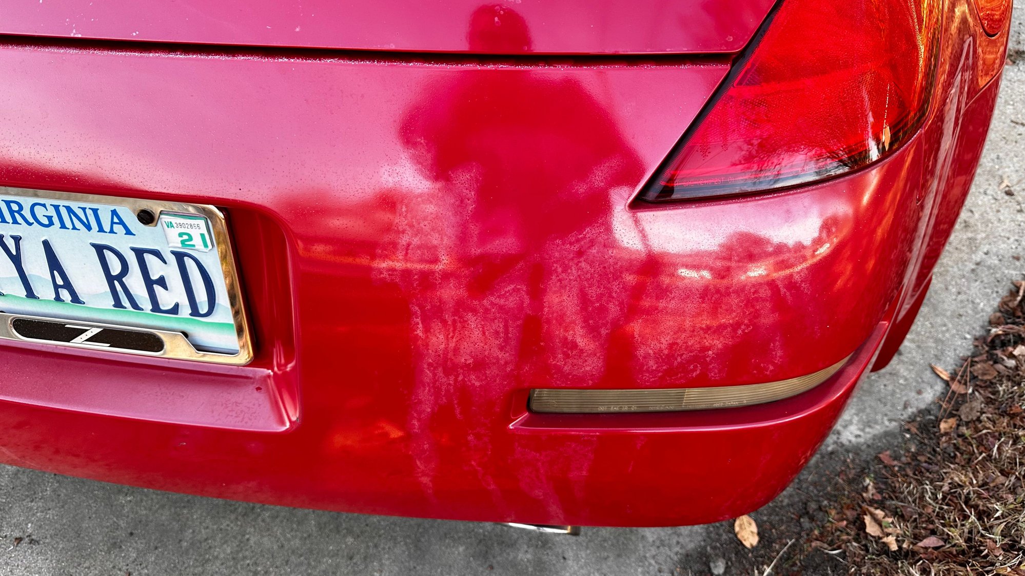

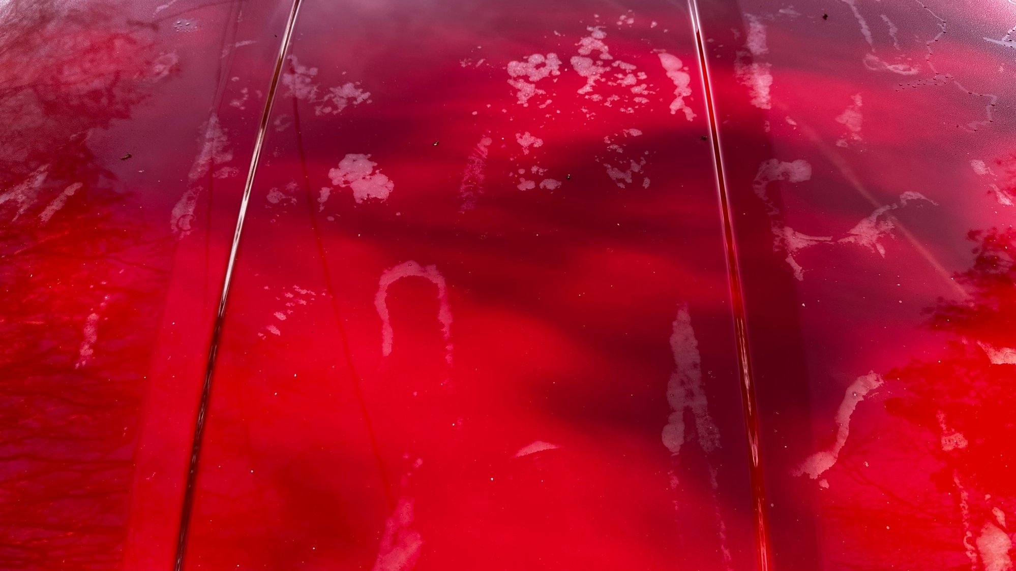

i did follow up with a detailer and unfortunately he wasn't able to remove the damage. What should I do Now? Please Help.

I can't tell if that's just the clear coat, or if the paint has been compromised as well. If it's just the clear coat, then it looks like it will need a proper wet sanding and several new coats of clear to fix that damage.
What kind of cover was it under?
