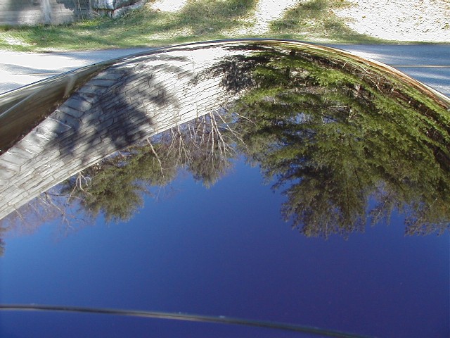

But, to show everyone there are no "Zaino-mind tricks" going on here, I offer this pic of the roof of my Z. This is with 6 coats of Zaino (Z5, Z2, Z2, Z5, Z2, Z2) with alternating layers of Z6...
