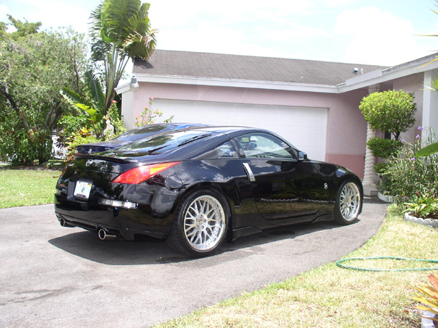

You be the judge. Took forever, wait let me emphasize, FOREVER. But I guess it was all worth it. ENJOY!

Looks like it was worth the effort. Very fine!!
