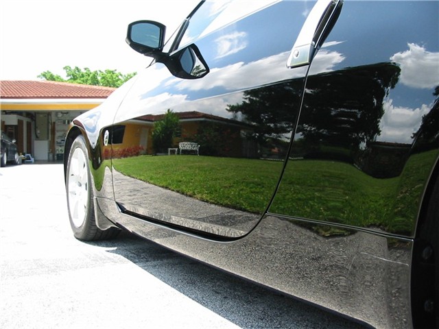

Ok, I did the claying as well and then a Z-7 wash after claying.
Results:

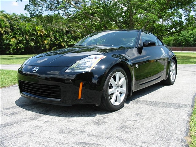

Oh btw took about 5.5 hrs to do all the steps here... glad I don't have to do this many steps on a regular basis.

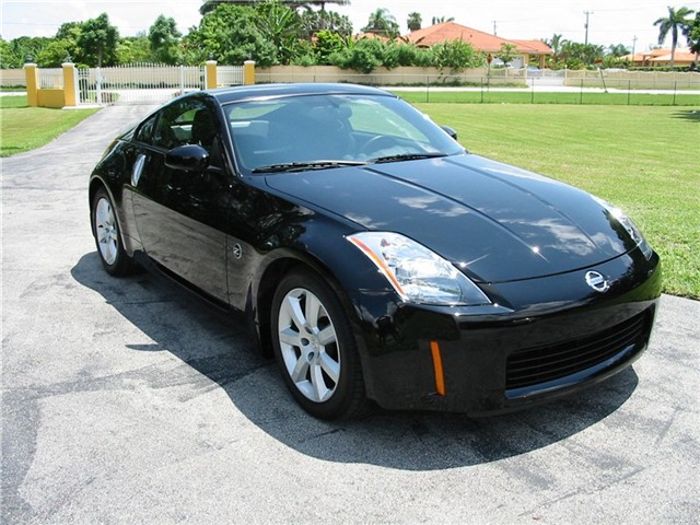

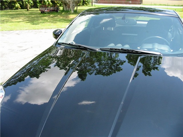

and last...

Thanks for all the help w/ the many questions about towels and products and everything else that I read in back posts. The car looks amazing.
BTW, I'm totally and utterly exhausted!
Old Jul 24, 2004 | 11:29 AM
Dr Bonz's Avatar
Dr Bonz
Charter Member #19
Posts: 6,490
From: Zainoland
There ya go! Very nice! Nothing like a Zaino shine on a dark car.
Ya gotta love the clouds on the hood pic

your black z looks awsome. Are those streaks i see on the hood, or is that just the picture? Either way, the car looks amazing.
