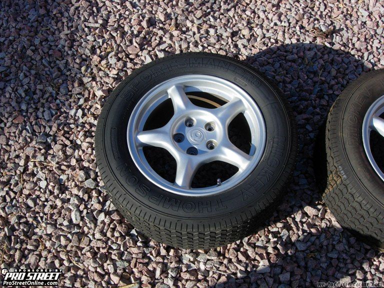

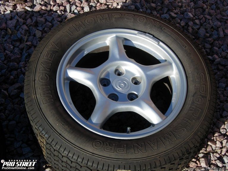

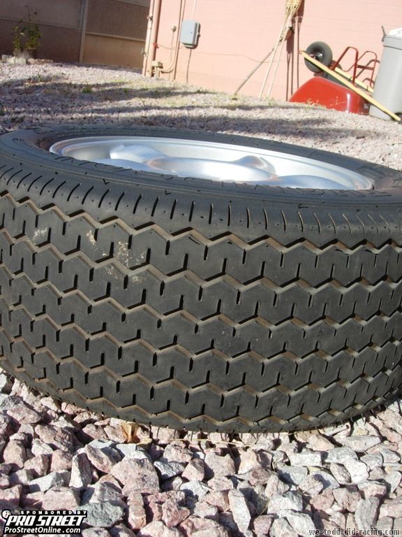

Hey guys their is a guy that is selling me 26x9.5x16 Mickey Thompson Sportsman Pro Drag tires on stock 94 FD 16x8" wheels for 250 shipped COD is this a good deal. And also how much do the light FD wheels weight on average with tires like this if anyone has an idea. Let me know Thanks
Here r some pics
Attached Thumbnails To all drag racers let me know if this is a good deal-wmtizmjgwmjzzndezzgzkmzf5ntqx.jpg   To all drag racers let me know if this is a good deal-wmtizmjgwmtzzndezzgzkmzf5ntqx.jpg   To all drag racers let me know if this is a good deal-wmtizmjgwmzzzndezzgzkmzf5ntqx.jpg

It's probably a "good deal" as far as the money you'd be paying vs. the money the setup would cost if you bought the wheels and tires separately (assuming new tires). However I know absolutely nothing about those tires, and they don't appear to be exactly the sweetest drag racing tread pattern I've ever seen. They look like they belong on a never raced deuce coupe at a hot rod show, or on the back of an 83 camaro in a trailer park because the NASCAR hat wearing owner thinks they look "cool."
Old May 9, 2006 | 07:13 PM
Nealoc187's Avatar
Nealoc187
Posts: 1,038
From: Winfield, IL
Of course I could be completely wrong... but I've never noticed them on any car at the drag strip.

Good deal. There are 2 versions of that wheel one is 13lbs other is 16lbs, both very light. If you have Brembos Im not sure if they clear if not go for it.

The 94 wheels are 16 lbs.
The year of manufacture is stamped on the wheel. If it says 92 or 93, than it is 13lbs. 94 is 16 lbs.
I weighed mine to be sure, even though one said 92 and the other said 93.
Those tires will squirm, if you run radials up front. Just a heads up.

The picture you see is what im getting. My only concern is to know if those tires hook.

If traction is your primary concern over price, I would look elsewhere.
I would go with some Hoosiers or ET Streets. Those are OK on the street where no heating is required, crappy on the strip.

I don't think the seller classifying the tire as "soft" is the best way to choose drag tires but that's completely up to you.

The Sportsmans only get greasy when heated, not sticky.

i cut plenty of low 1.7s on those tires. I would spin to that 60'...it was great. I liked them myself
