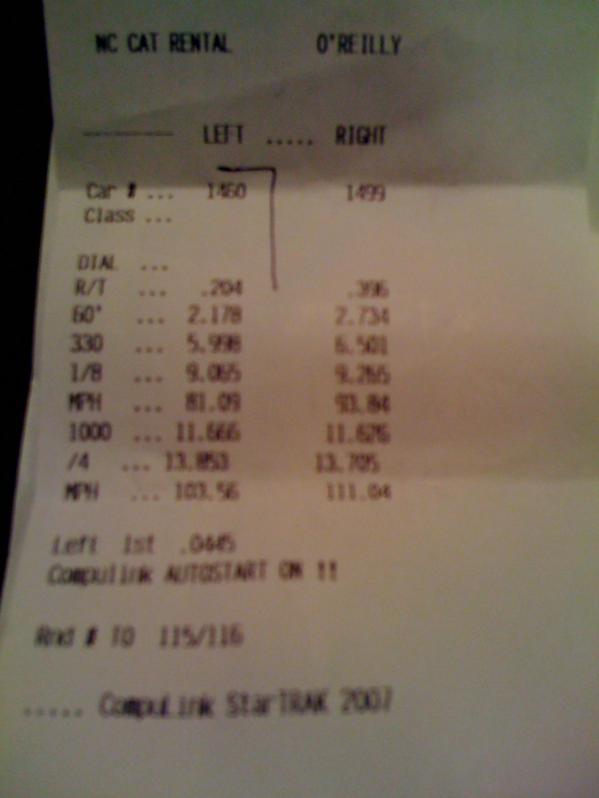

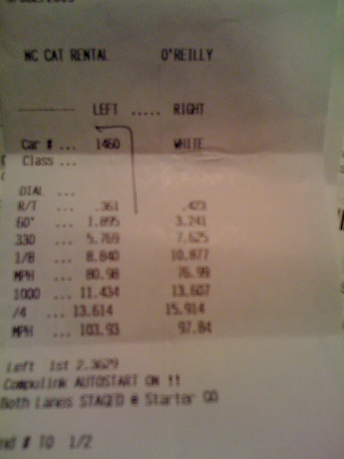

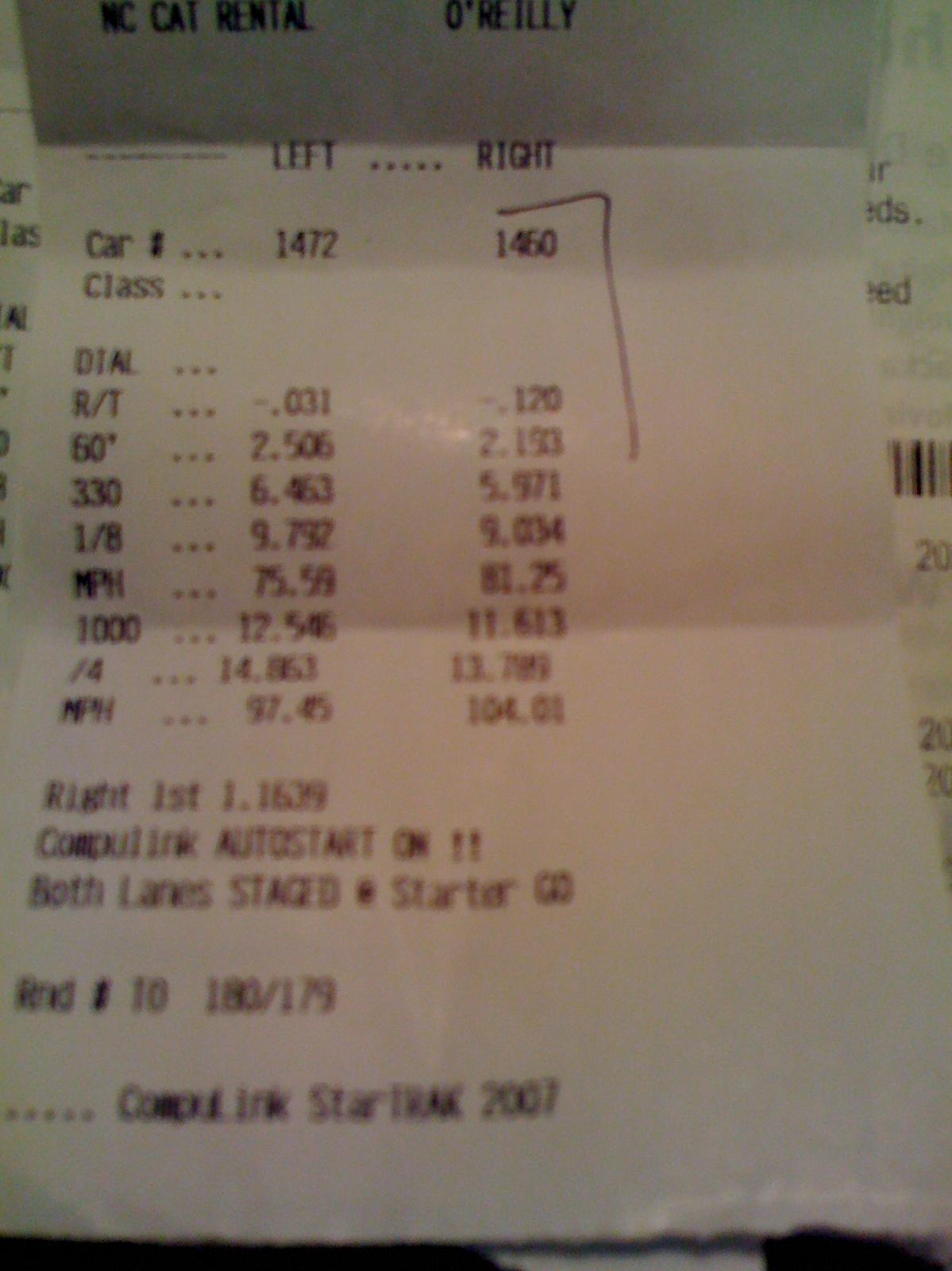

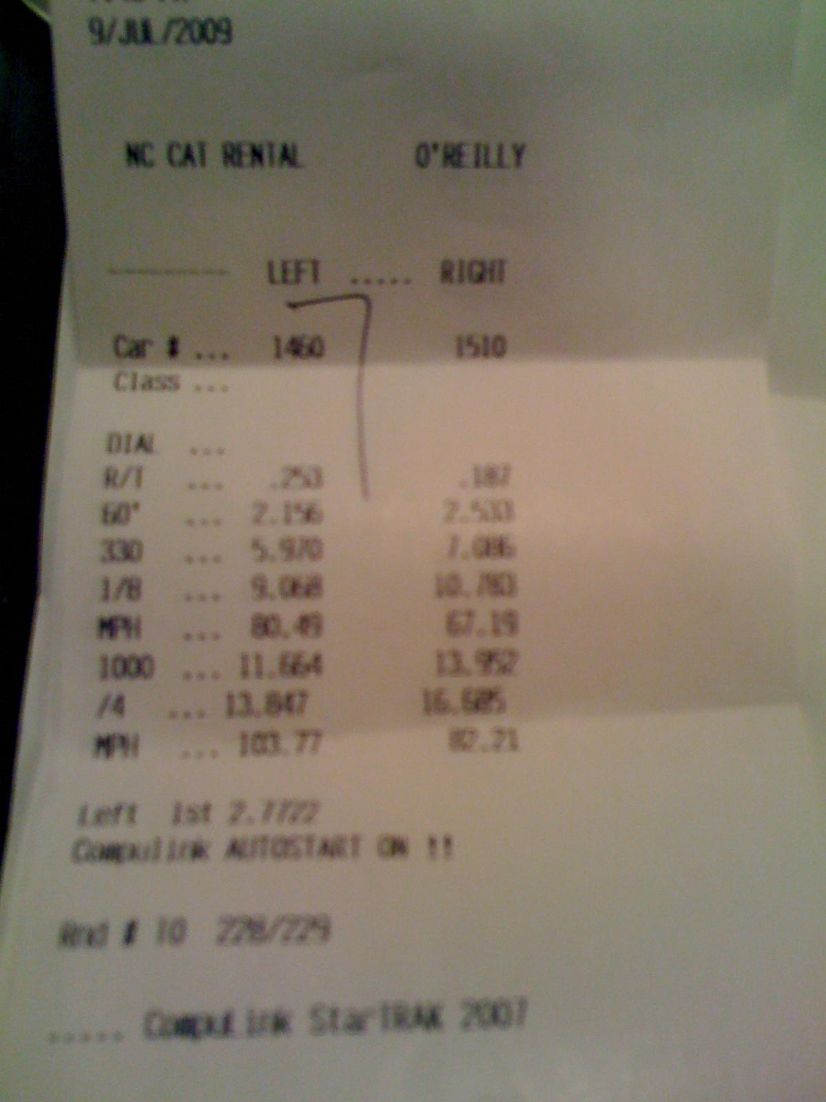

Here are the slips from all runs i made! I consider myself not the best driver, and i'm hoping for some improvements! I pulled a mesmerizing 1.89- 60", which completely threw me off, as i expected to have run faster 1/4 mile. Well, i will let you guys give me your feedback.
This is a 2007 HR with bolt ons and technosquare tune. Lowered 2+ inches!
Attached Thumbnails A Puzzling Track Day-010.jpg   A Puzzling Track Day-011.jpg   A Puzzling Track Day-012.jpg   A Puzzling Track Day-013.jpg   A Puzzling Track Day-014.jpg

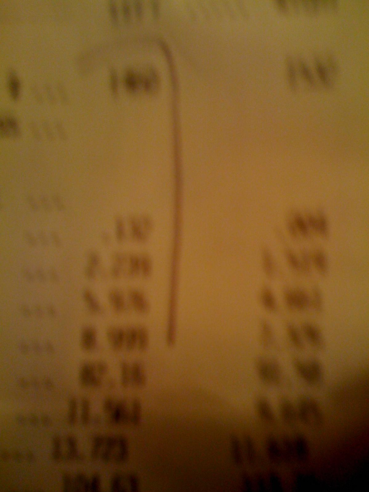

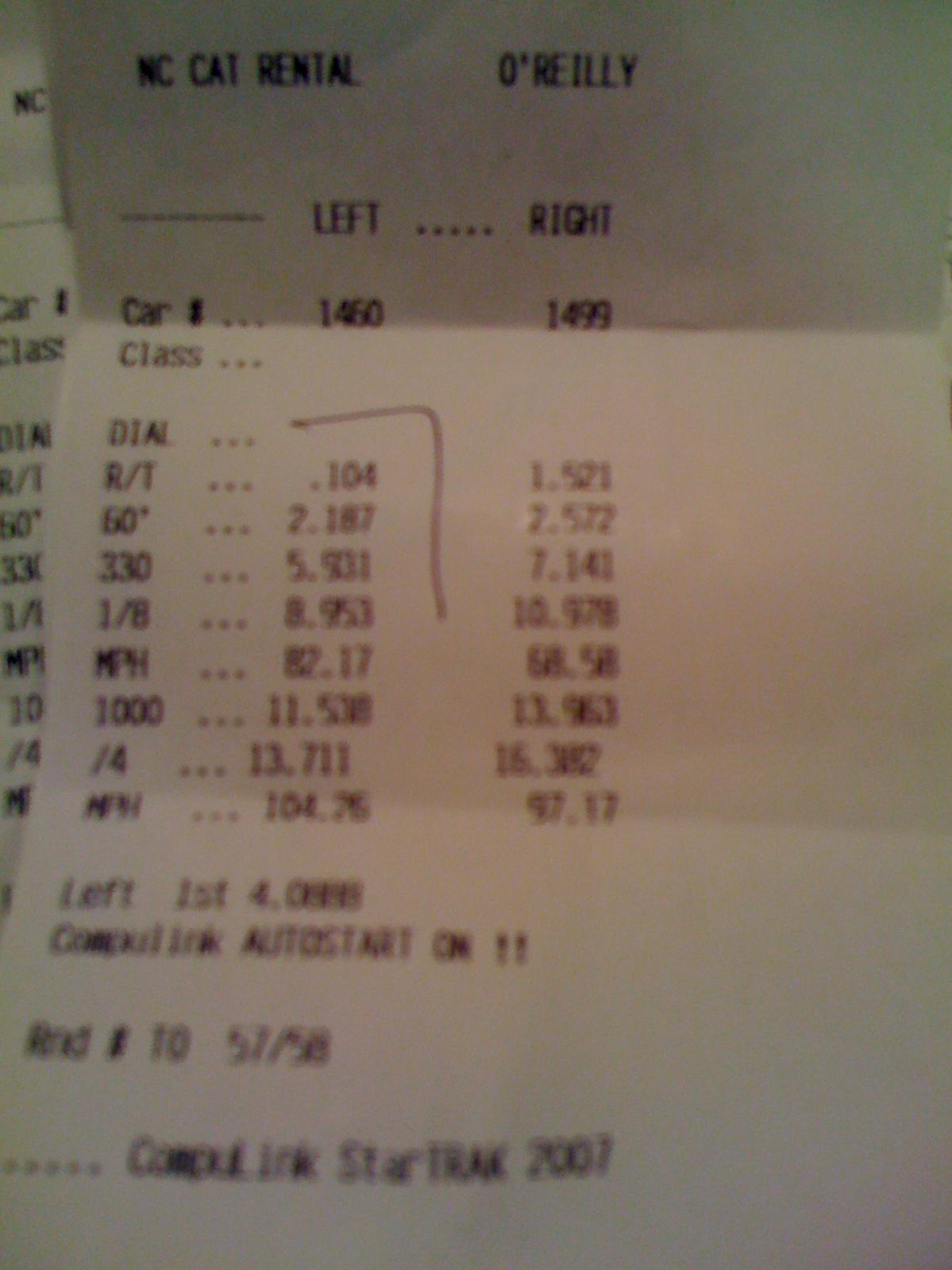

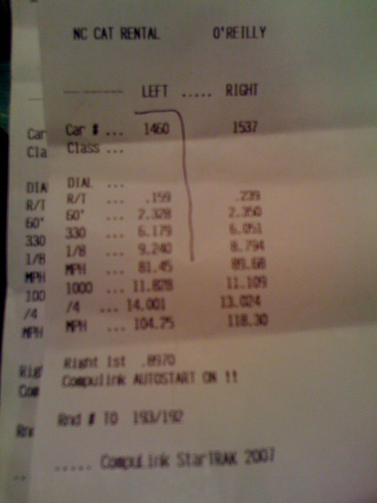

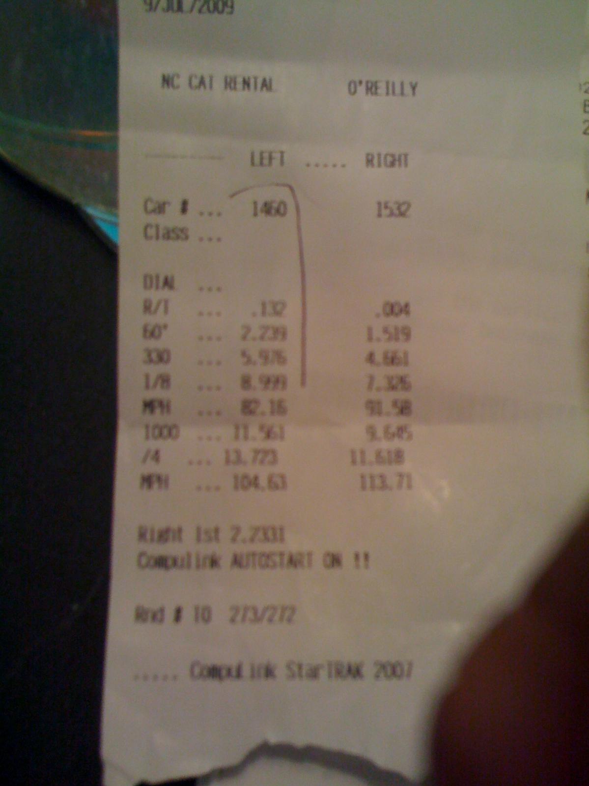

more
Attached Thumbnails A Puzzling Track Day-017.jpg   A Puzzling Track Day-016.jpg   A Puzzling Track Day-015.jpg   A Puzzling Track Day-014.jpg

Someone must have put glue on the staging pad. Nice driving.
Times are good but I see one number that stands out for improvement: 1/8 mile trap speed. 80.9 MPH. This number is the result of second gear acceleration. One of the time slips shows a 82.1 MPH 1/8 mile trap.

The 1.89 was my very first run. Also, i was the first car to run on the track after the prep.

did this launch "feel" faster than the rest? 1.89 and 2.1 is a very noticeable difference. I'm not trying to talk you down or anything, but it might have been a glitch in the timing system. cause i've "ran" a 1.6 60' before at pacific raceways, but i know for a fact that it wasn't a 1.6.

As far as times, the pass with the good 60' you hadn't launched hard enough. Your 330' time is over .1 seconds off where it should be for a "record" level pass. If you look back at my slips or Veetec's, you'll see 5.5/5.6 range 330' times. That means that not only are we getting through the 60' traps fast, but we are keeping the engine from bogging as we finish first and get into second. If you don't launch with enough RPM, and the engine bogs, the car won't pull through the 330' as fast, and you're times will look like they do. If you launch higher and use more clutch to keep the tires planted through the 60', then the engine won't bog, and you'll have a faster time.
Good runs though, I also wouldn't lower the tire pressure that much, I found mine grip best between 33-36 psi.
