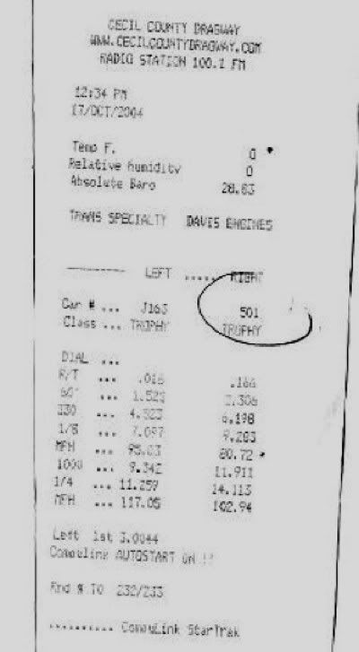

Look at the difference in the time slip above. This is a all motor 350Z.
You beat me (#501) out of the hole by 1/10 seconds.
I make that up and best your 330 feet by 1/10 seconds.
1/8 mile and I am 2/10 seconds ahead.
1/4 mile and I am 3/10 seconds ahead. This is not the result of any secret drag racing techniques. Just practice.
