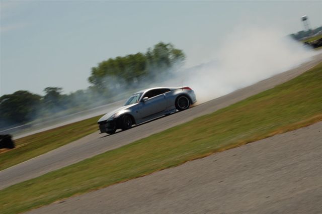

smoke comes from multiple things, such as tire choice, air pressure, ect. the biggest thing you can concentrate on is throttle commitment. the longer you can keep your foot in it from beginning to end, the more smoke you can make. this comes from alot of practice, ect. you can also of course up the hp, be in the correct gear, ect.
here is a pic of me putting up some smoke on a road course. i was just running about 35 psi, which is nothing crazy at all, 3rd gear, about 350whp or so at best that day, 255 falken rt615s tires.
and please don't concentrate on smoking tires so much, smoke doesn't make good drifting. concentrate on the basics or line, angle, speed.
