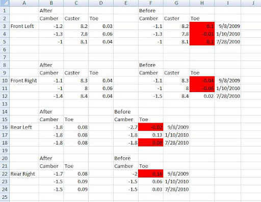

NismoZ_840's Avatar
NismoZ_840
Joined: Apr 2009
Posts: 315
From: Denver
Originally Posted by 350zRiot
You do 3-5 ax or track days a month and get your car alignment check only twice a year?
DO you usually go when you see the uneven wear pattern or just go to the alignment shop every 3k-5k miles and say that you check you alignment often because you track your car?
Yep, the only thing that is usually out of spec is the toe, mostly in front but a little in the rear. Here's the history...
Firestone actually recommended every 5K when I bought the plan, but I go sooner if the wear seems too uneven or is pulling. I'm tracking the measurements to get a better idea of how quickly it deviates.
Wear is somewhat even except front outside shoulder wear because the Stock front camber is a little weak for AX/track and the rear seems to be a little too aggressive on camber (i.e. inside shoulder wear), but not a lot. The out of spec toe is probably accelerating the uneven wear by scrubbing the tires more than it should. Nothing extreme though. Sometimes I feel a little pull on the highway, but it will do it even after a alignment. I think it's more tramlining and/or ruts though.
You could probably go more frequently and avoid the out spec of toe quicker, but I still got 12 track days on Hankook v12s (street tires) without much uneven wear. That is acceptable to me; I'm not concerned about having ideal camber and toe for each event at this point. Most of the uneven wear was from the mainly clockwise tracks and AX courses pounding on the left side. I did do one left to right, flip tires on wheel, around day 8.
Next step is SPL arms up front this winter. I'll wait and see how the back holds up. I run square, but directional, so I can swap front to back to mitigate some of the inside/outside wear.
I hope to get a handle on alignment and wear before switching to stickier, more expensive tires, since the wear will probably be more pronounced. Then I'll fine tune for performance. I'm just a recreational racer so I'm not trying to squeeze every ounce of performance out, mainly just trying to keep tire costs down while I build my driving skills.
+1 on the Suspension 101 thread, I learned a lot from that thread.

The ones you highlighted in reds aren't that much of a difference to show uneven wear patter, IMO. toe should be fine under .1.
I did read suspension 101 thread but i'll go ahead and read one more time.
