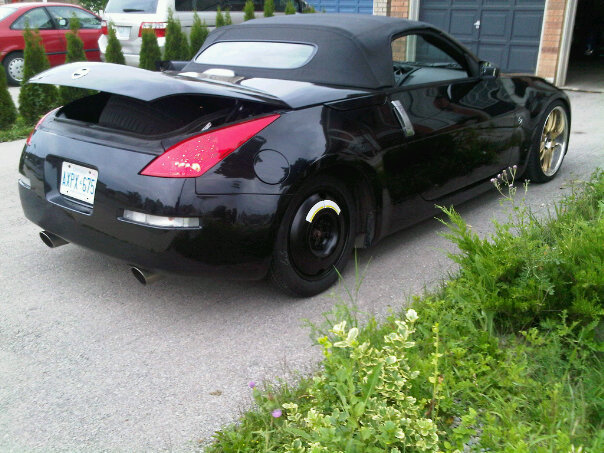

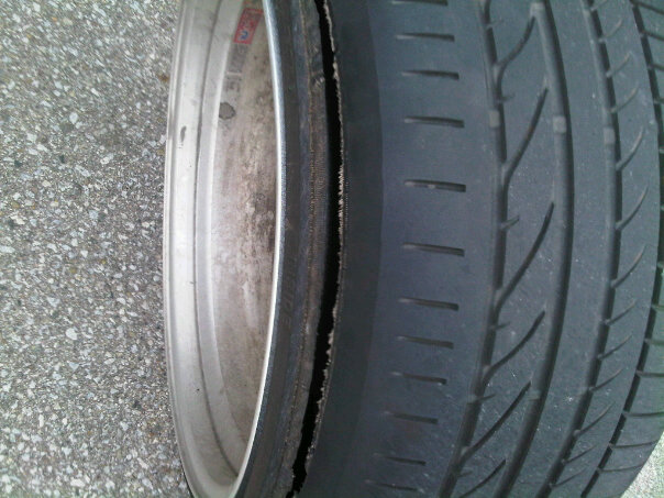

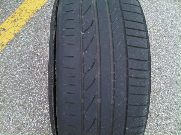

Wow .. never had this happend to me ever .. but last night driving home my tire blew out .. less than 2 seasons. Dont have a clue how this would have happened.
The Z is safe .. the volks are safe .. guess its time for some new rubber
thinking 285's this time.

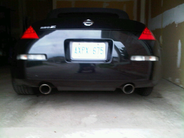

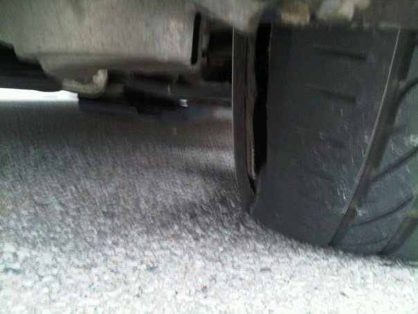

Negative camber, plus a little toe, throw in a stretched tire, and maybe low tire pressure.
I could see a tire doing that to you. Obvious signs of wear are on the inside of the tire.

Yeah dude the insides of those were toast... still a bit of a rarity though. You need an adjustment, count your lucky stars this wasn't a far more negative situation though.
do you check your tire pressure regularly?
